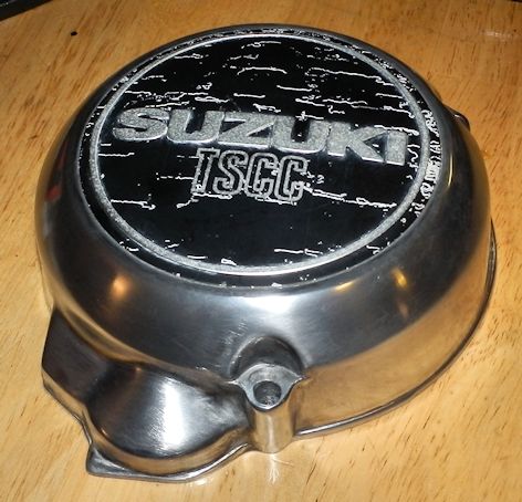

Does anyone know a good way to remove the old badges and install the new ones??
How do I remove the old case badges ?
My case covers have been nicely polished, now I want to replace the old Suzuki TSCC badges with a set of NOS ones I purchased.

Heat up the badge and it will come off easier.Ed
Yep, warm them up. I start by prying just a bit at the very top, then spraying in a bit of solvent. Might be carb cleaner, brake cleaner, acetone, whatever is closest, but apply some to the gap at the top of the badge, it will work its way down, making the rest of it even easier.
.sigpic
Heat from the inside of the covers like was stated. Utility knife blade to get ahold of the edge and start it off. Keep it heated ( I use the propane torch myself ) just enough to keep it peeling off. The left behind adhesive is easily scrubbed off with some steel wool and acetone. Just did this yesterday to a set that I was polishing.MY BIKES..1977 GS 750 B, 1978 GS 1000 C (X2)

Gonna stink in the oven...hope its an outdoor oven. Maybe try the BBQ grill as the heat source.MY BIKES..1977 GS 750 B, 1978 GS 1000 C (X2)
