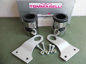

                    Originally posted by Weasel View Post
                    I'm assuming I can lose the headlight mounts, they don't appear to offer any structural support to the forks. I plan on adding a smaller light and custom mounts anyway.
                    Ebay or Google image search for Tommaselli style 35mm headlight brackets. I got some from maybe AlphaMoto for like $25, sometimes they sell for upwards of 60. The actual Tommaselli brand are more like 70.these are the best kind to get by far, they have a large rubber cushion under the clamp and the ones that I see more frequently for 35 mm forks also have a rubber cushion at the headlight mounting bolts. I ran some aftermarket rigid headlight mounting ears for a while, and my halogen bulb burnt out within 100 miles and I was running the high beam only for a few rides... I realized it was from vibration, immediately got some generic Tommaselli's. very few aftermarket brackets have rubber mounts, and just a little rubber mount at the headlight bucket mounting bolt point in the bucket is not nearly enough. unless you have a Cadillac suspension on a vintage sport touring bike
                    to weed through all of the stuff on the internet and find out what I need faster, I typically use a Google image search, and for this I just searched headlight mounting bracket 35mm rubber.search for Tomaselli headlight bracket first so you know what you are looking for. You can also buy just the rubbers, I see them for sale in Europe more often, but if you are making your own, definitely buy those rubbers that clamp around the fork.
                    the actual Tommaselli brand have aluminum ears and the Tommaselli logo engraved into the back of the clamps. The ones above I see frequently especially for CB 750 and 35mm GS forks, they have the additional rubbers at the headlight mounting bolt, which is very nice, very thoughtful of the Chinese engineers to do that! Chinese parts aren't all that bad sometimes! I would buy the Tommaselli's for sure for my Rickman GS project if they only made them in 43 mm!

                        Thanks once again Chuck. You are the man! I agree on the Google image search. Makes finding exactly what you are looking for really easy.
