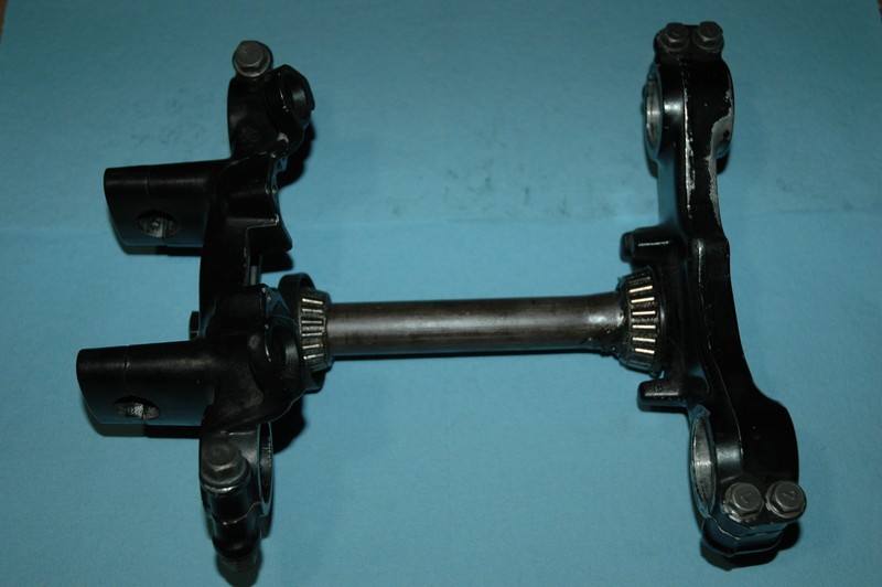

                          Thanks Chuck but I already have $100 invested in powder coating on the lowers so I'm going to figure out how to refinish or get a replacement set of stock ones. I called the Harley shop I used to frequent because they used to send out parts for my HDs to get chromed all the time. They gave me the name & number of the chrome shop they use. I called the guy & he said no problem, bring them by for a quote. I'll keep you posted on what he says.

                            My fork seals & steering bearings showed up today along with a halo headlamp with black housing. It's a 5.75" diameter and will look way better on my minimalist front end than the big 7" stocker.
