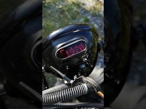

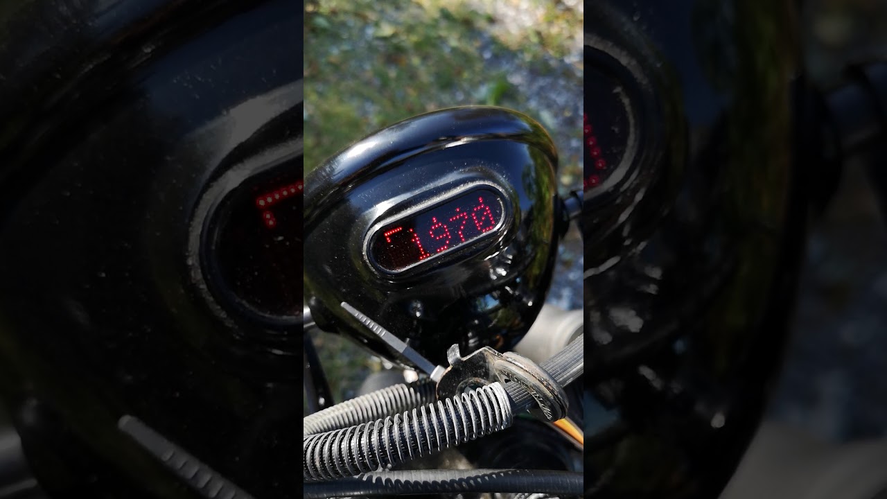

                                So.. work has taken a lot of time the last few months, but I'm back Still working on the design for the petcock, but I've also come up with a solution for the pickup for the digital speedometer. I'm using the original gear on the front axle and the original wire. I've then cut the coupling and bearing out of a broken speedo and made a new house for it with a small disc inside. The disc has a hole for the magnet and the lid has a hole for the magnetic pickup. What do you think?
                                Speedogear_final by Lars Krogh-Stea, on Flickr
