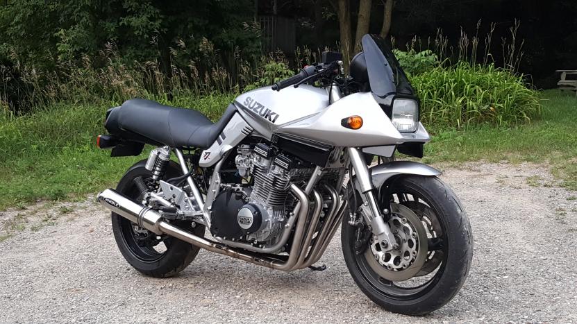

            Almost done my build
              Aaaah, saw this on FB. Beautiful.
                Looks great, Eddy.
                What's left to do?
                  Looks great, Eddy.
                  What's left to do?
                  Just need to fire it up and hen off for tires and a safety
                  Drew
                    Decided against the orange frame? Looks very nice. Should be fun to ride, for sure.

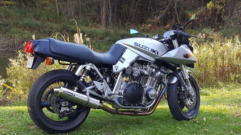

                                Bike is completed and on the road. I have a few things to iron out but all seems to be good.
