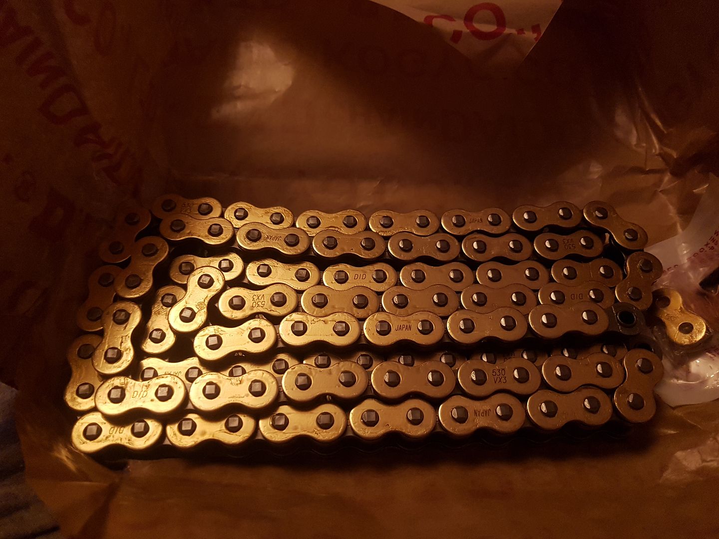

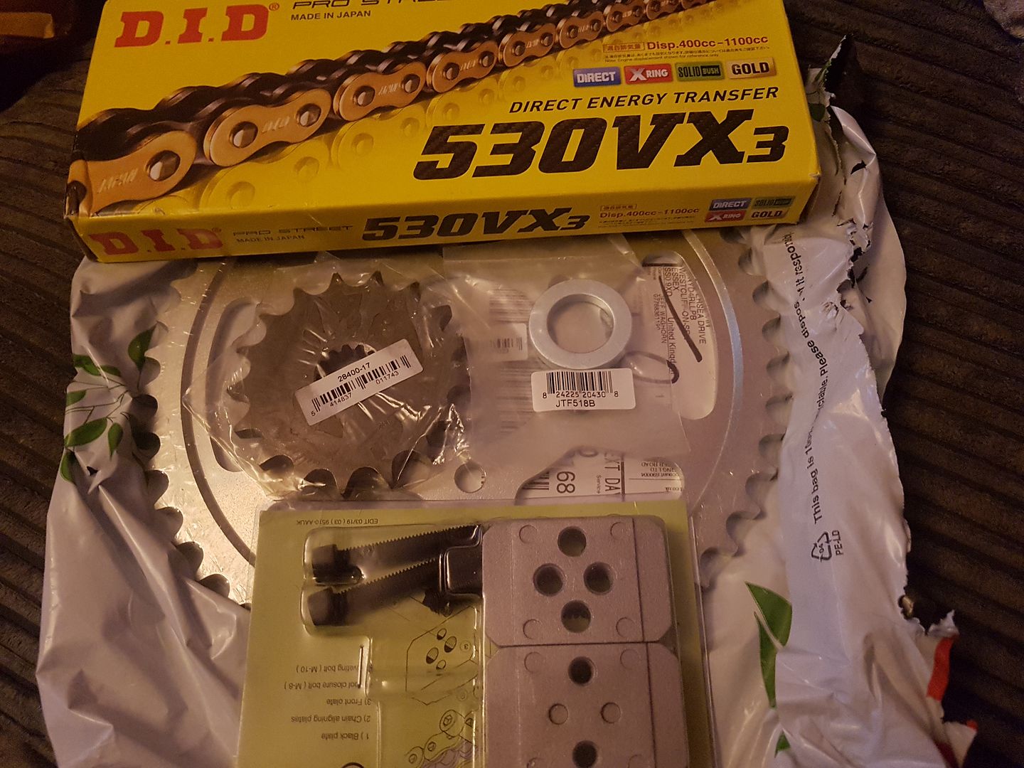

                      When I checked the bike over after a good shake down which included 2 track days at Brands Hatch motor racing curcuit in Kent UK I found the chain had started to tighten up on a number of the links. The chain set had been on the bike since being finished about 7 years ago so I have had a good life from the set.
                      The bike has the standard 630 pitch and I thought 530 would be the best way to go.
                      I went to a local motorcycle parts dealer and they provided the whole kit for £112.
                      The kit came with the spacer for the front sprocket.
                      I also went for the gold bling version..
                      I rather like the end result.

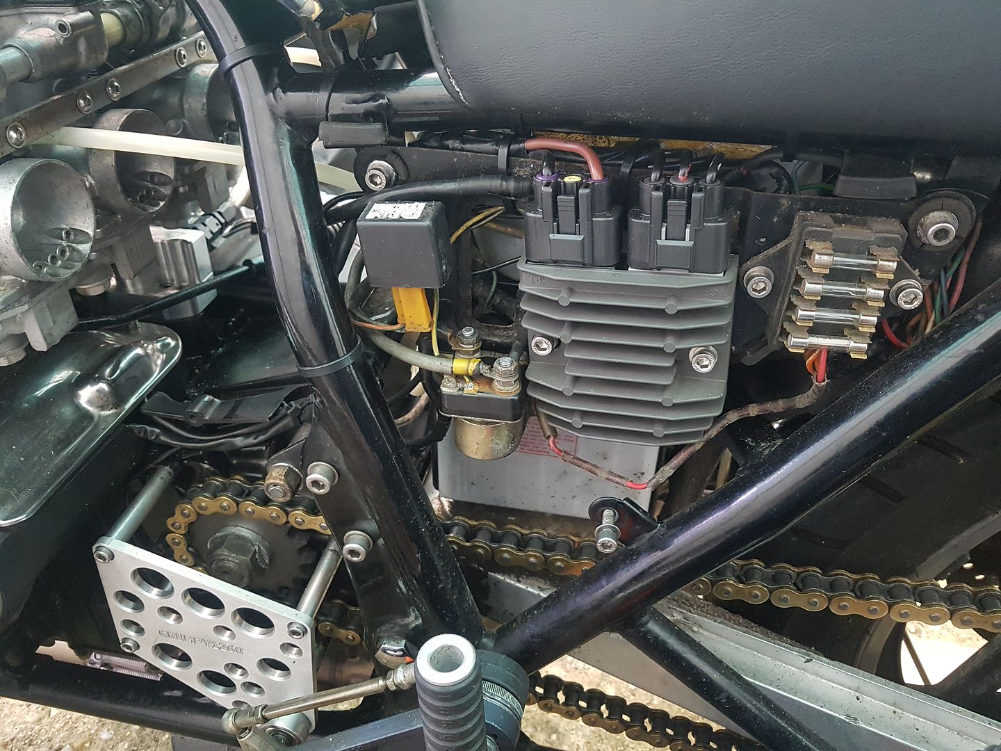

                            If you haven't already... I'd re-solder that fuse box & then "pot" it with Araldite. I had problems with a couple of them over the space of a couple of years but none since I did that on one about 8 years ago

                              #44
                              Thanks for the tip Dan as I have not done that yet..
