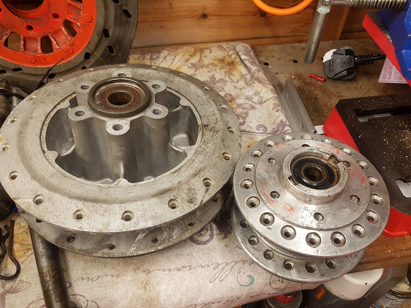

    Originally posted by bobtail84 View Post
    I have made a late night purchase....
    I have sent the hubs to a wheel builder and after a lot of serching and reading on this forum I'm going for 2.5 X 18 front and 4.25 X 18 rear aluminium rims.
    I have looked at and read all the info by Sharpy, Storm 64 and Chuck78 and the detail is fantastic, all the work was done for me so all I had to do was decide what sizes I wanted.
    When the wheels are back I will post up pictures.
    Yes, some good discussion back then. Private message me if you have any questions. (R.I.P. Sharpy)

            Cool! Was it hard to find the rear hub? I bought one some years ago, and it took some searching.. I went with 4.25X18 rear and the original 19" in front. Lately I've switched to 3.5x19 in front and a GSX-R fork and the 4.25 rear matches that nicely.
            This is what it will look like with a 150 tyre, but you are maybe going for 160?

              The Hubs are quite scarce in the UK so when I saw this pair I snapped them up sharpish.
              I am going to fit a 160-60 18 in the rear & 110-80 18 on the front.

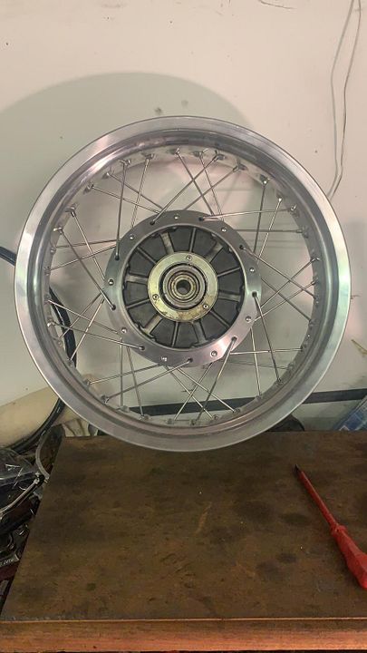

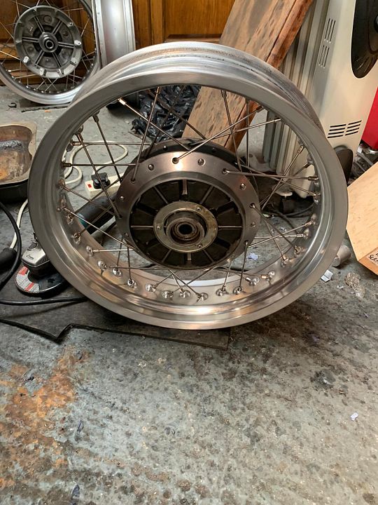

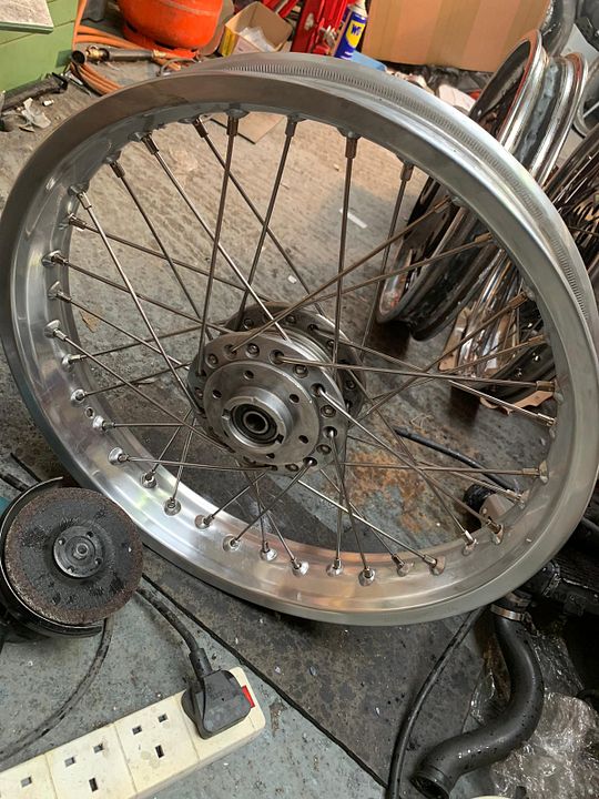

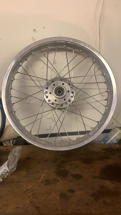

                  Update time..
                  The wheel builder has sent me some pics of my completed wheels which he has boxed up and posted, they should be with me at the weekend.
                  I have also had the tyres delivered as well, they are Dunlop sportmax alpha 13. The rear is 160/60 ZR 18 and the front is 110/80 ZR18.
                  Jeff
                  Living the dream...

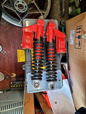

                            #58

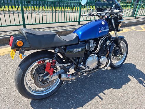

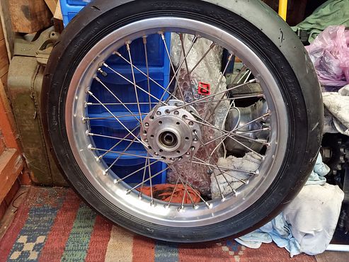

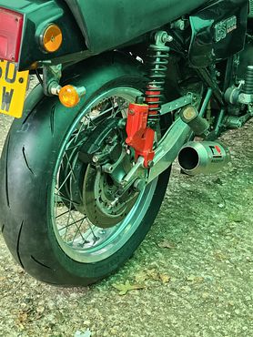

                            Up date time..
                            The wheels have been built up and balanced.
                            I've also found and puchased a pair of marzocchi strada shocks which are in very good condition
                            They look very nice on the bike.
                            All in all I am very pleased with the end result.
                            Jeff
                            Living the dream...
                              #59
                              WOW,
                              Your bike looks awesome!! Well Done with your project.
