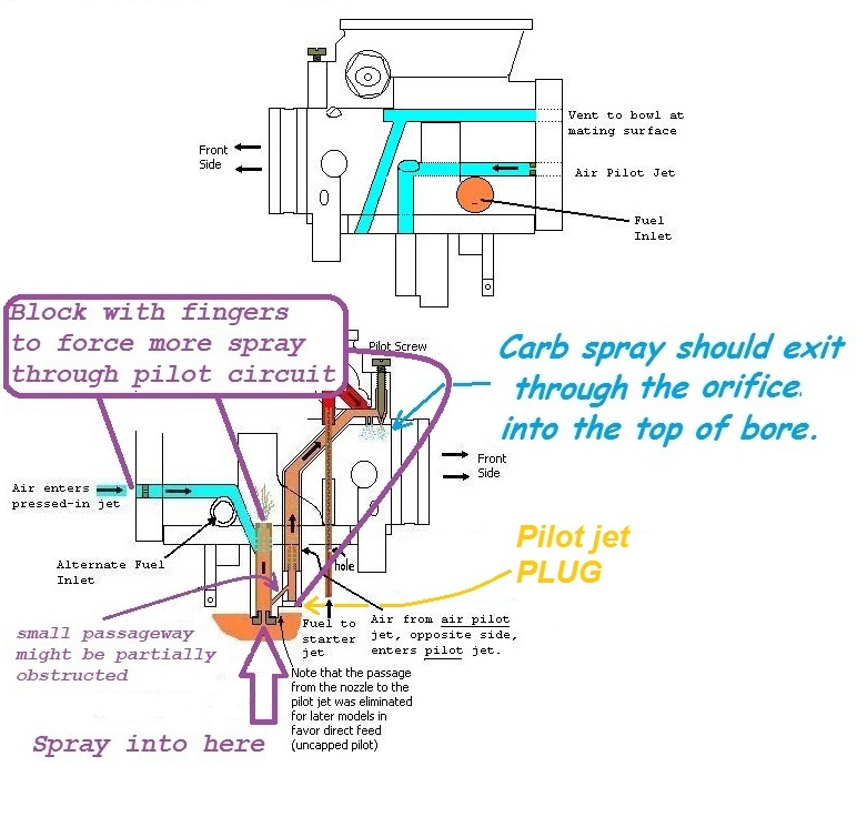

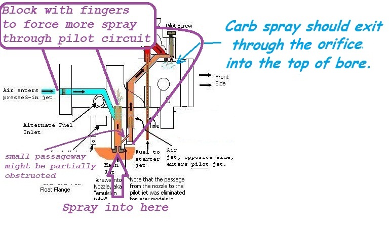

    You mentioned carb rebuild and Suzuki carb kit,but it sounds like your pilot jets are clogged or the circuit is.Can you shoot carb spray through the pilot jet and see itcome out the transition holes at the butterfly, through the air jet at the front, through the fuel mixture screw?

      Labels are not quite right, Rick. The only GS carbs with diaphragms in '78 and '79 were on the twins.
      He has a 1000G, which started in '80. They are at least the correct carb and the "spray through the passages" concept works well.
        That was the best I could find on short notice to illustrate what I was saying.

              The GS850 manual on Basscliff's site has a good section on the CVs. I like to do the spray through as a final check.
              I have had a blockage between the pilot air jet and the progression holes at the butterfly. I've also had mains and pilots that passed fuel OK, but the emulsion tubes were so messed up that the fuel did not atomize properly, and the bike ran like crap, even though the spray-through looked OK
