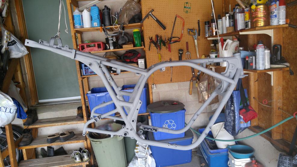

              Got the frame primed and painted today, also did some very minor frame bracing while I had the chance.
