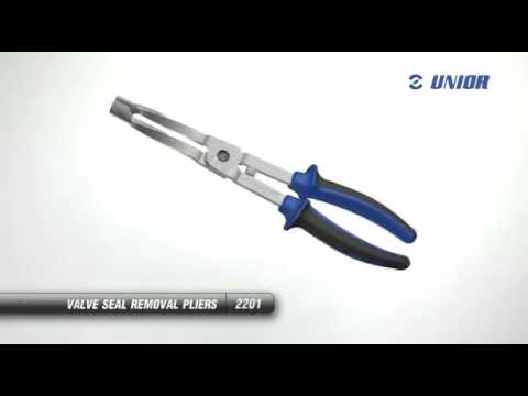

                  -The cylinder head is in very nice shape. All valve tappet shims are in the higher thicknesses 2.70 to 2.80 region. The valves seat have not been lapped too many times, if ever, because they are fairly narrow. The valve seals need to be replaced. Question: is there a special tool for pulling the old valve seal off?
                  There is a valve seal removal tool that I used, which made removal a breeze, compared to struggling with baked-on rock-hard lumps of carbon down a hole.
                  Last time I did this the seals were only a decade old and quite easy to get out using ordinary long-nosed pliers; not so, this time.
                  Identical to this tool, I got mine from a local supplier. They're quite common, as a whole raft of modern engines need them.
                  For those on the UK side of the pond, they cost a tenner.
                  I got mine from Maun Industries, and they turned out be Sykes-Pickavant branded iirc.
                    #39
                    Thanks for that Grimly. I already have the valve seals removed but would be worth having for future reference along with the JIS screwdrivers.
                    Those metal clad seals are a bear to get out I but managed it with a crude tool I made from a piece of tubing. Getting the new seals in is also awkward due to them being down in a hole. I ended up putting the valve in, put the seal on the end of the stem and then slide seal/ valve down onto the top of the guide.
                    i used seals for an '84 Honda Prelude which I have used successfully on my GL1100 and are much cheaper than OE.
