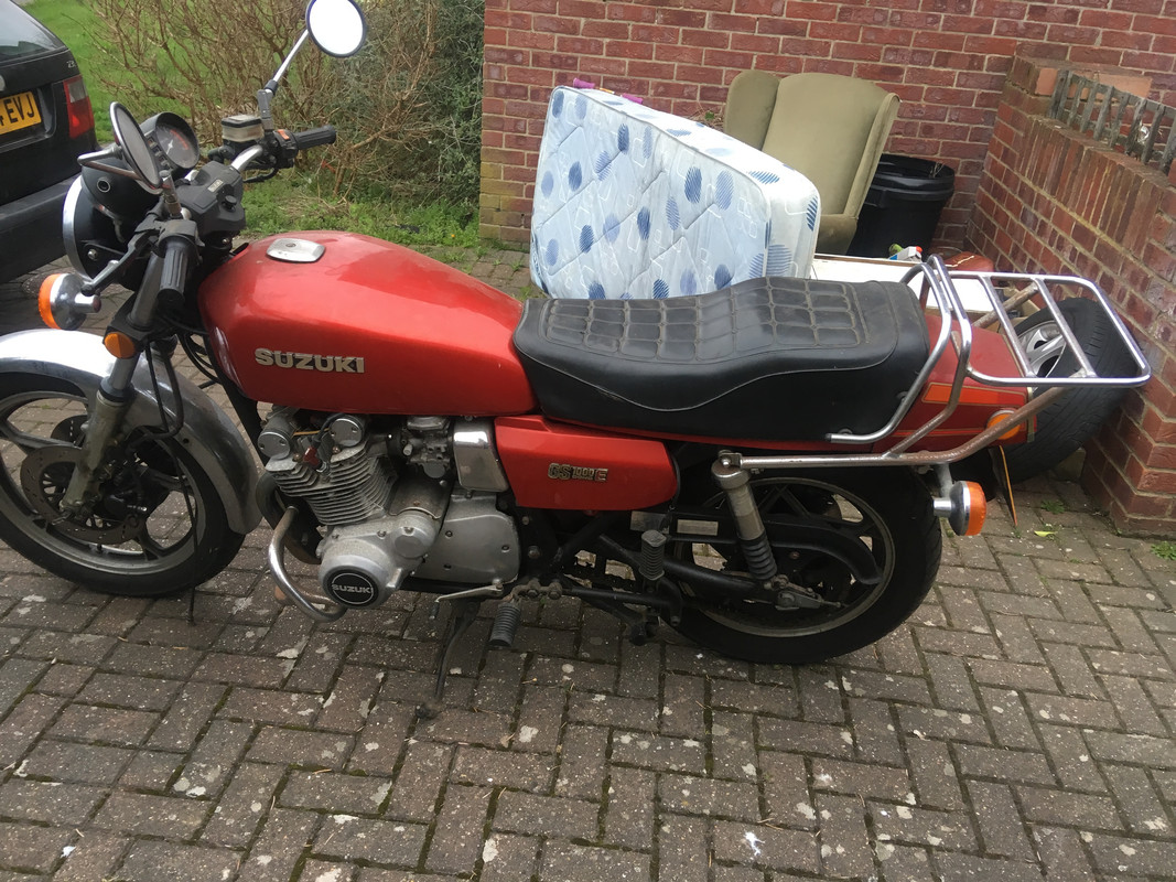

    I bought this 1981 GS1000ET in 2006.
    She standard including the rear air ride suspension, rear rack, crash bars. She is missing her side panel and tank decals but I do have new replacements, just got to find a painter who can put them on plus laquer the tank to cover them up.
    I rode her till 2010 when the head gasket started spewing oil from the cam chain tunnel and also from the near side pinch bolt area. She wasn't smoking and pulled like a train so it was just a small job of pulling the head and a new gasket.

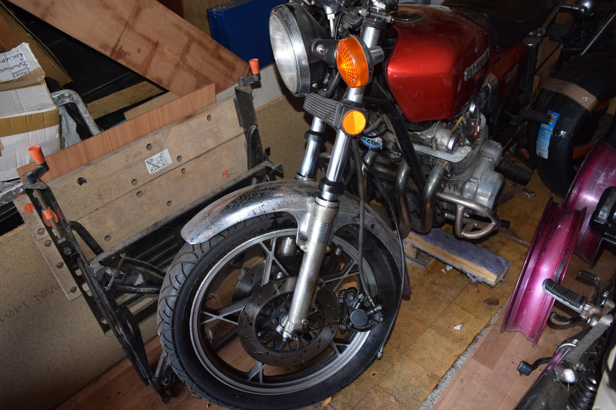

          Right, spare day today so out with the spanners.
          I'm going to work in the garage to start with taking the forks off and outside to work on in the lights.
          The issue has been getting the top caps off as the bottom 'allen' bolt has been rounded.
          Loosed the top yoke (triple trees for you guys) and lower pinch bolts so twisted the caps around to get a spanner on them.
          For being together for 38/39 years it came apart very easily without damaging the top cap which is an obsolete part from Suzuki. (I managed to find 3 NOS Parts on ebay if anybody needs one.)
          Loosen the caps enough so I can get the guts out and attack the rounded headed bolt from inside.
          Lifted the bike up on some home made stand....

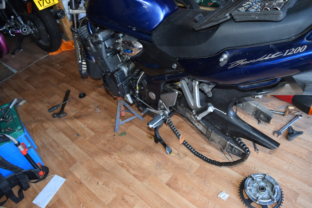

          ...as I'm working on a more modern bike at the same time....
          It's a 2nd cousin (GSF1200K2) that needs new tyres for the summer season.
          As you can see, fork oil has got everywhere.
          New brake pads are going to have to be a must on this. Saying that, new new most things are going to be needed after 9 years lurking in the back of the garage.

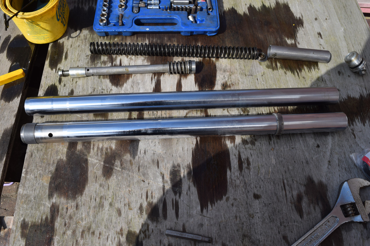

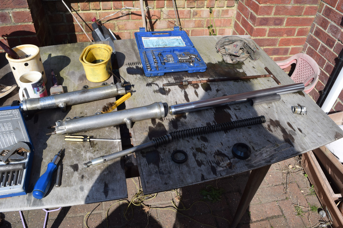

            Forks are out and on the bench (well lets say old kitchen table. )
            With the upper air cap loosened off it was a quick unscrew and no damage occurred. Phew!!! Out came the long spacer, spacer/washer and the spring. Drained what oil I could out and then using the 'home made' (thanks Bro) tool all a 8mm Torx bit the Allen bolt came away. It was pretty tight whoever put it in last. Out came the lowers and they were cleaned up. So here's the forks in bits.

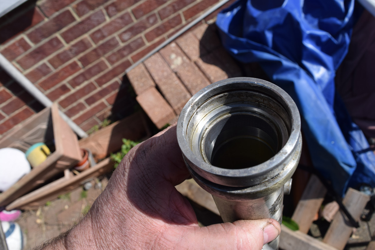

            I'm sure there is one piece missing and that is the spacer that joins the outer leg to the inner tube. Looking at the leg its stuck in the top of the leg.
            I have no idea at the moment on how that is going to come out looking at the wear marks on it. Or for that matter how the new one will go back in. Any suggestions guy's?

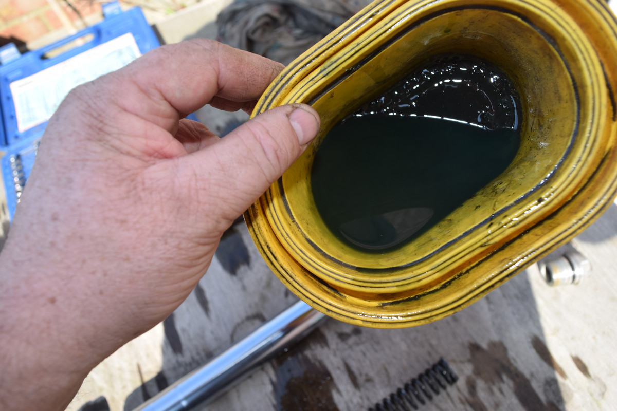

            The oil that came out has seen better days, don't you think?

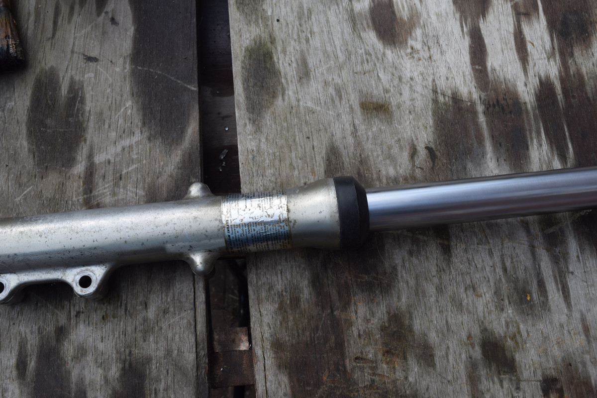

              Into the parts store, we all have these don't we? Came out with 4 pairs of NOS fork legs. Pull the first set out the box and match them up......
              Somethings wrong. Completely different. 51110-49560 part number.
              Pull the second set apart and....
              think we have a winner! Yep. these are the same but no part number.

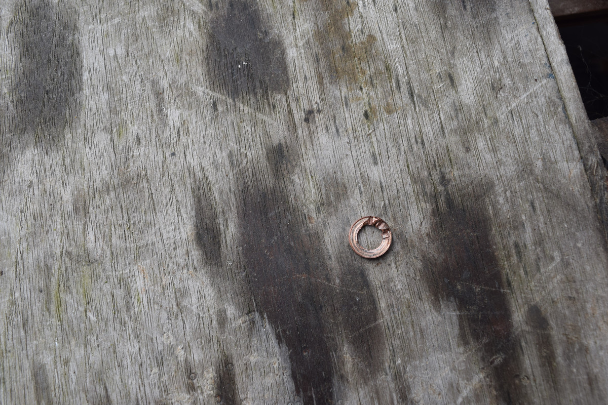

                        So the morning turned out fun today. Waited for the post and nothing came. Called the UK's largest Suzuki parts dealer (who's 20 miles away) and they had the bits on the shelf in my Account bucket waiting for me to collect. Put the phone down and the wife TXT. 'Can I drop her glasses over as she had left them at home.' The joys of getting old.
                        So a quick plan and pack up the bike and off I set.
                        First stop was Roadstar cycles. A little known local bike shop that deals with old 'British bikes' and a few other makes along the way. They also do UK MOT's..... I showed them my fork tubes and the crushed copper washers. I'd spent 40 minutes with a pick and screwdriver trying to lift the washers last night but had no luck. The guy had a look at the two tubes, asked which was the worst, could the washer be damaged and once satisfied he set off to his bench sticking the leg in a vice on it.
                        A small ball peenee hammer and a chisel he tapped the copper washer muttering how somebody have really over tightened it and how thick the washer was. He quickly moved around the shop to find a trusty small but bent screw driver. Must have been a favourite. Put the screwdriver in the slot, a little push and out came the crushed washer.
                        'That was fun' he mutter handing me the leg and damaged washer. After no charge for the one he got out and saying do the same on the other I was on my way. Dropped the wife's glasses off as they were about a mile apart and then up the road to the Suzuki Dealers.

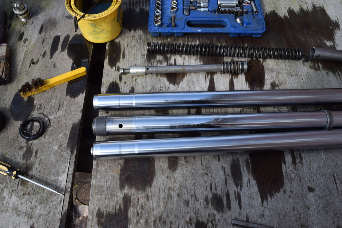

                        So I carried on. Tubes out, new parts out and special tool out.
                        Stand tool upright into fork tube and inner part. Inner sticks out and put cap on. Then insert outer leg over this, till home. Add new copper washer and bolt into the hole in the leg and tighten down with a 8mm allen key and torque to 19ft lbs. (Yep I'm old fashioned.)
                        Turn it upright slide the new seal down the tube, put the old one onto and tap it home. Take old seal off put new retaining ring on place and then fit new cover.
