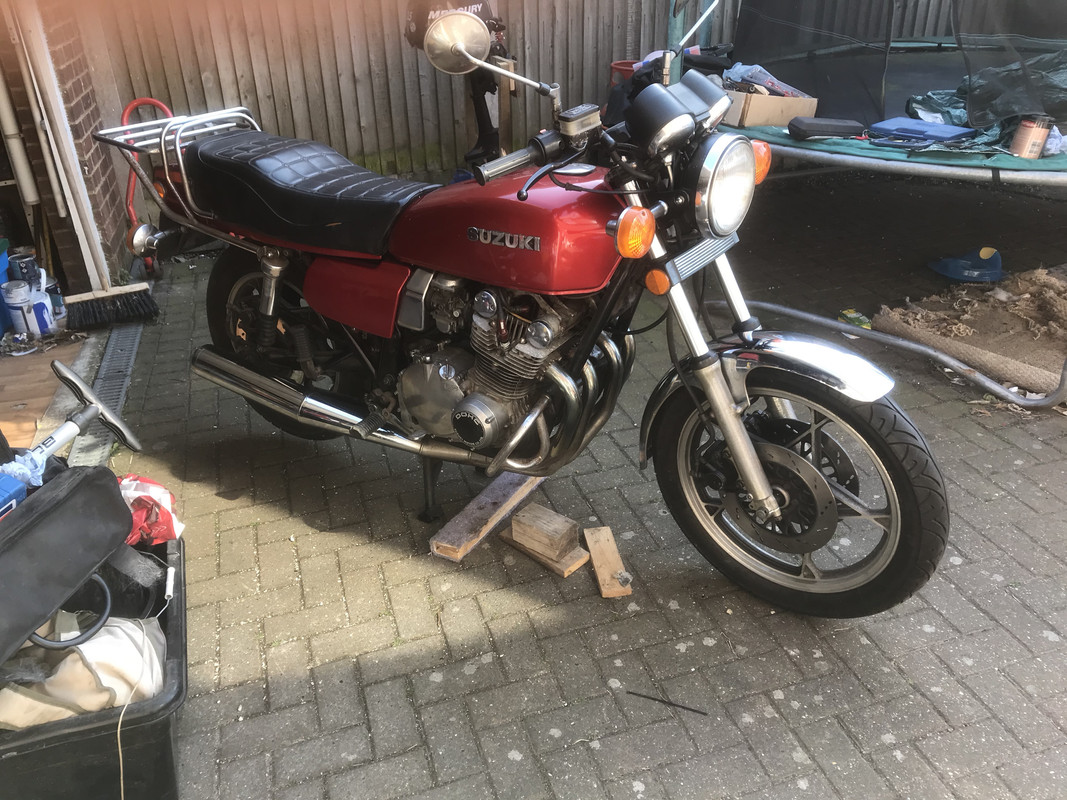

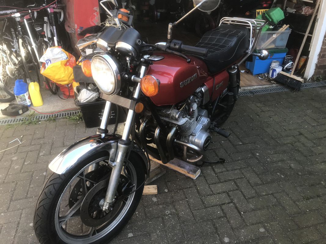

    Last time she was out of the garage in about 2010. Excuse the rubbish pile.
    And today.....

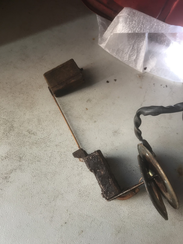

                  Well this is the fuel gauge sender unit....
                  It's rather rusty and when I connect it back to the power and the bike, lift the float the unit sadly doesn't operate the fuel gauge on the clocks. I'm not sure if it can be repaired or I am going to have to find a replacement one from somewhere.

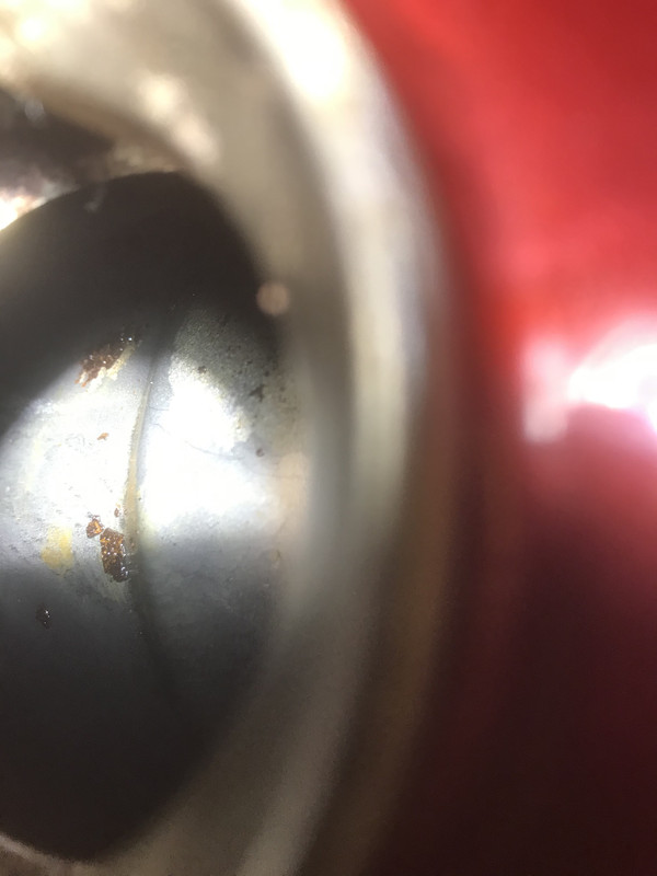

                  This is the filler cap and inside the tank.
                  I've done nothing to it other than just take the filler cap off. Doesnt look too bad.
                  Trying to show you further into the tank and hoping that it will make sense. It doesnt look bad but I'm going to have to do something with the rust. Oh well.

                        Member Admiral Beez recently paid for the rebuild and recommissioning of his fuel sender. Seems like a nice job.
                        Tri-Starr Radiator offers expert repair and custom rebuilds for Harley-Davidson fuel sending units. Trusted since 1993, we specialize in hard-to-find and obsolete fuel senders with a 1-year warranty. Contact us today!
                        Shipping to and fro will nearly double the cost ($100), but it's a one-off cost and will work for another lifetime.
