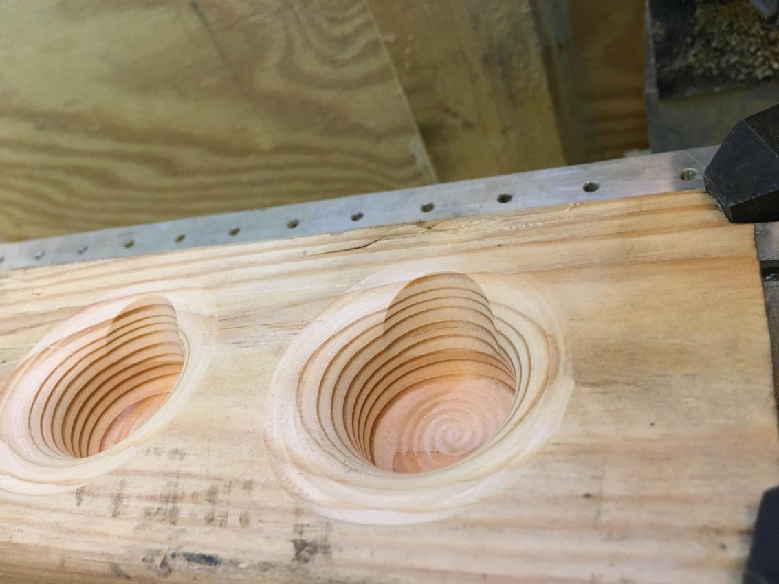

    I started an EFI conversion for my 850 a bit over a year ago. I started with 1999 Suzuki GSXR750 injected throttle bodies and home brew, cnc cut adapter manifolds to adapt them to the GS850 head (protos cut from wood). Almost exactly a year later (with no activity) I redesigned and re-cut the proto manifolds. I ordered most of the expensive hardware (fuel pump, plumbing, blank fuel rail stock, fuel pump and filters, Megasquirt).

      I've been stumbling a bunch as the spacing needed for the 850 head doesn't give enough room between the outer throttle bodies but finally settled on a design/modification to make it work. I've designed two butterfly shafts, one for each outer pair of throttle bodies apposed to four separate shafts.

          Adaptions should be easy. I just need to get measurements off the heads. But at over 4 hours of mill time in wood it is a bit time consuming to cut he manifolds. Cutting in aluminum could almost double mill time. I am working on a third design though which I hope will cut down on mill time.
