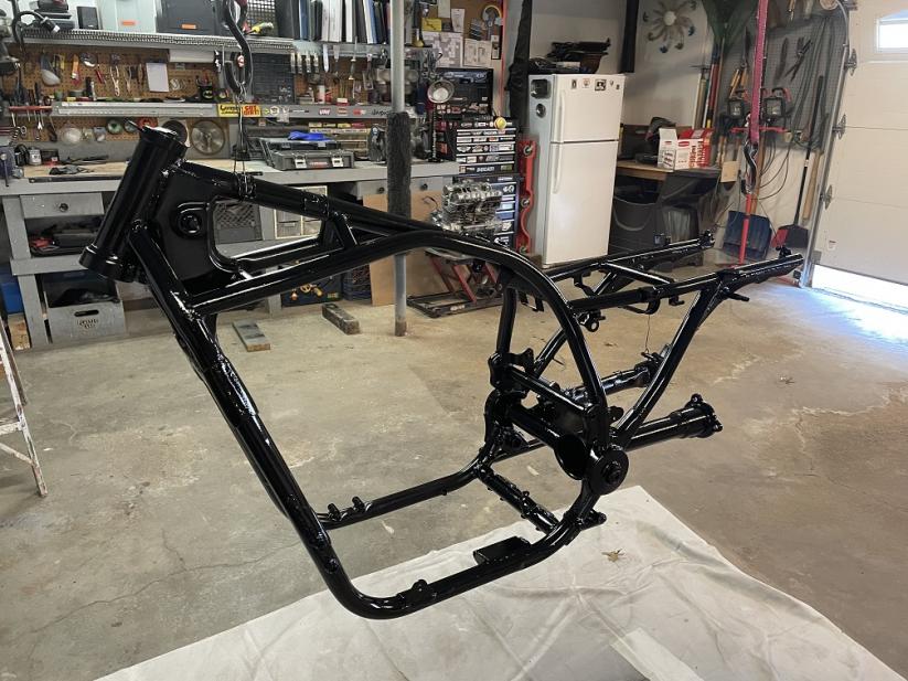

        Resealed my tensioner, so it doesn't leak, but I still have a leak on the left side. It still appears to be coming from the base gasket, so I've ordered base and head gaskets and o-rings. Base gasket is back ordered, so while I'm waiting I tore everything apart. I striped the rattle can off (acetone, yummy), sanded and painted the frame. Did the same with the wheels, and I should have those painted and a new front tire on tonight (rear tire is nearly new, so won't be replacing that one). New fork oil and seals after that.

          My gaskets and o-rings all finally arrived, so I was able to get the engine back together and into the frame. I've been able to make some good progress getting the thing reassemble. I should have it running next weekend, but I'll have to get the WaveRunners out of the garage before I can paint the tins. They've got issues too, so it may be a few weeks. Some photos of progress so far.
