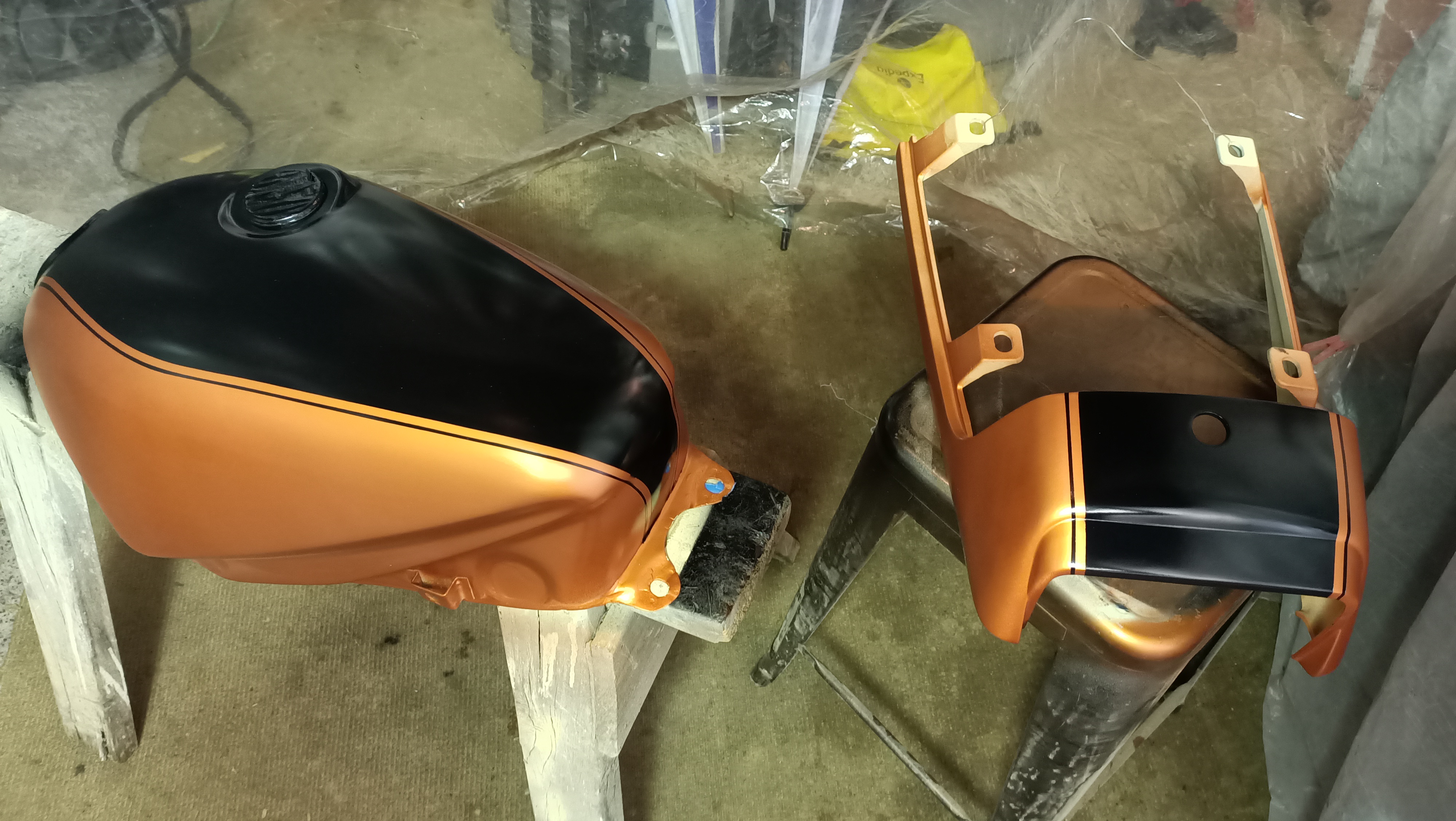

Ok... white pinstripe, red pinstripe or no pinstripe? Each works with other colours on the bike. So what are you thoughts?

My first attempt at painting a second color and masking pin stripes. Actually it's the second time I've spray painted a bike bodywork. A few tiny bleeds but all nowhere they will be obvious.
Black Pearl
I'm tossing up whether to add some white or silver pin stripe tape. Either way I'll spray clear, flat back, apply the decals and then lay wet coats of clear.

Thanks Larry, the Black Pearl will be on the top of the tank, the front of the fairing, back of the front fender and a stripe across the tail. The Tiger Mica is the main color.Originally posted by alke46 View PostAmazing how good new paint looks, even if it is not the final color. Keep on keeping on.

Got to the point of diminishing returns on tank and panel prep, so sprayed the first base coat color, Tiger Mica.
It's not show pony perfect, but good enough that I won't look at it and feel regret. Good enough for an occasional ride, which is her intended use
Wet sanded the primer filler with 600. The water sheets on the primer when it's rinsed and gives a good indicator of how ultimately the clear coat will sit. The reflections in the water are what you look at
I'm going to mask off and spray the second color, Black Pearl. Flat back, a coat of clear,.decals and pin strips, followed by two wet coats of clear. Then the engine work begins.
