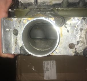

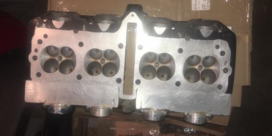

                      got a 1150 head. I was going to port my own head for this build but I found a GS 1150 head already ported with big titanium valves 33/27 to go with my 1640cc big motor. My little short bus is gonna haul a$$!!

                        Peek inside

                          That's some serious hardware there. 👍
