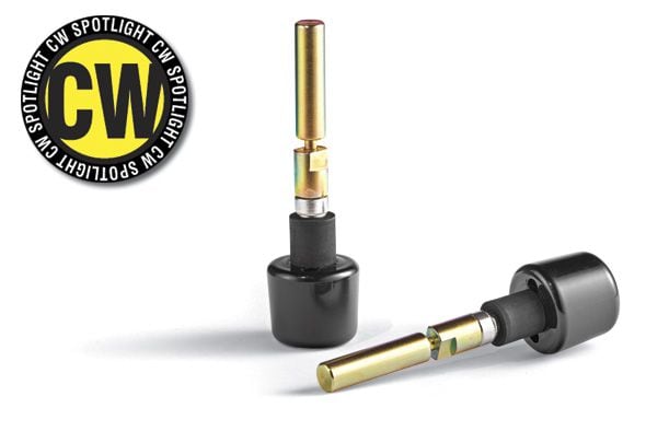

Now that I'm older, my hands are apparently more sensitive to vibration. I would like to add some bar-end weights to the stock bars on my 1100E's. However, as you all know, the stock bars didn't have any weights and don't have any welded-in nutplates inside the ends to attach any weights to if you wanted to. So my question is, are there any bar-end weights out there with a "wedge-bolt" type device that expands inside of the hollow bar end to attach itself to the bar-end instead of needing a nut-plate to be screw to? Just curious if anyone has seen or used such a end weight and if so, where did they find it. Thanks!

I used these on a KZ750E I owned. http://www.manicsalamander.com/products.aspx

Originally posted by OldSkool View PostNow that I'm older, my hands are apparently more sensitive to vibration. I would like to add some bar-end weights to the stock bars on my 1100E's. However, as you all know, the stock bars didn't have any weights and don't have any welded-in nutplates inside the ends to attach any weights to if you wanted to. So my question is, are there any bar-end weights out there with a "wedge-bolt" type device that expands inside of the hollow bar end to attach itself to the bar-end instead of needing a nut-plate to be screw to? Just curious if anyone has seen or used such a end weight and if so, where did they find it. Thanks!
Many (MANY) of the bar weights sold aftermarket or ebay are light aluminum and are mostly for show. This is why the OEM factory weights sell for more on ebay than brand new weights. The Hayabusa bar weights are highly sought after because they are freakin' huge. I know, I just picked up a set for my 1100, they just need some sanding and painting.
If you want to go high tech, the "Vibranators: get very good reviews but I haven't tried them.
koolaid_kid
Those vibranators look like a manic salamander clone. They should work in a similar manner, which is good but not perfect. Or moderately as the review states.
