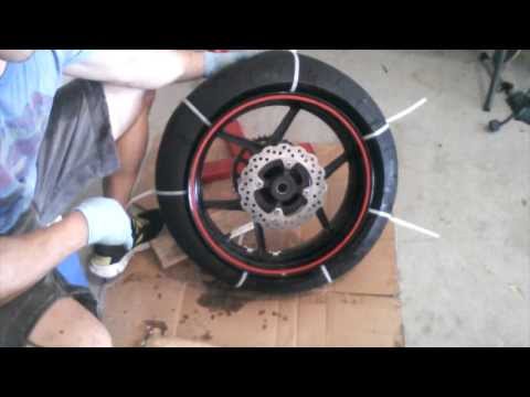

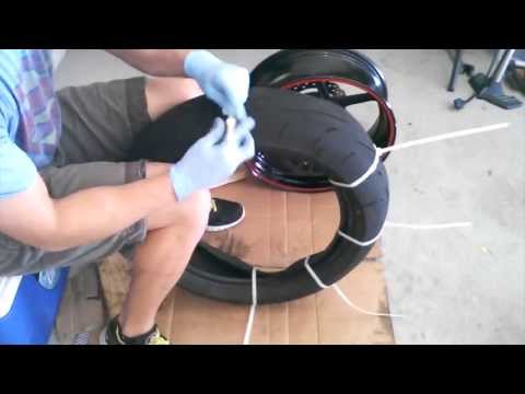

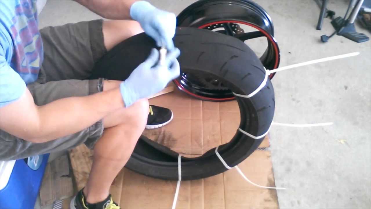

    Not sure if this has been discussed before, and too lazy to search the whole forum.
    I hear a lot about people being unsure about removing tires either due to lack of proper tire irons or for fear of damaging the tire and/or rim.
    Here is a clever way to remove and refit your tire using only a bunch of zip ties.

      I did the same thing for this riding season, except I used lash straps. Worked really well, and the straps are more easily reusable.
        The bead will pop on faster if you remove the valve stem insides
