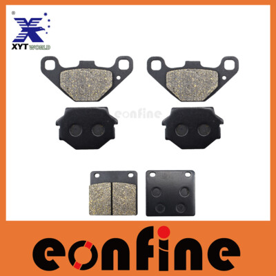

    Can anyone recommend a compatible pad that would be best suited?
    I found a few on ebay that were compatible....
    would these be fine? or is there something better out there?
    (SUZUKI GSX 400 FX/FZ/FD 1981-1983. Organic Brake Pads. Rear Brake. Front Brake. to get it.). Such asYamaha WR250 2016 model, you can searchWR250 2016 first, if no results, tryWR 250 or justWR. Policies & Conditions.
    Do you want the best possible pad life, or the best possible braking?
      My son also has a GSX400F and we recently put SBS pads on front and rear. They work fine so far.
      If you do not have a maintenance history of your bike from the previous owner, I would strongly suggest that you rebuild the front and rear calipers as well as front and rear master cylinders with new OEM seals. Do not trust aftermarket parts for this job. Just think of grabbing front brake when you really need it, only to find the lever coming back to the bar, to put you off considering aftermarket brake parts.

        I use EBC pads. The sintered pads may stop a little quicker but will eat your rotors. I like the Organic Kevlar pads.

          I've got Metal Gear organic ones on mine and happy with them so far. A whopping $15.50 for the set I think it was.

            thanks guys... think ill just try and error.. going for some organic pads first off.. see how they go
              This might be right for your bike, but not 100% sure:
              $16.95 for organic pads.
