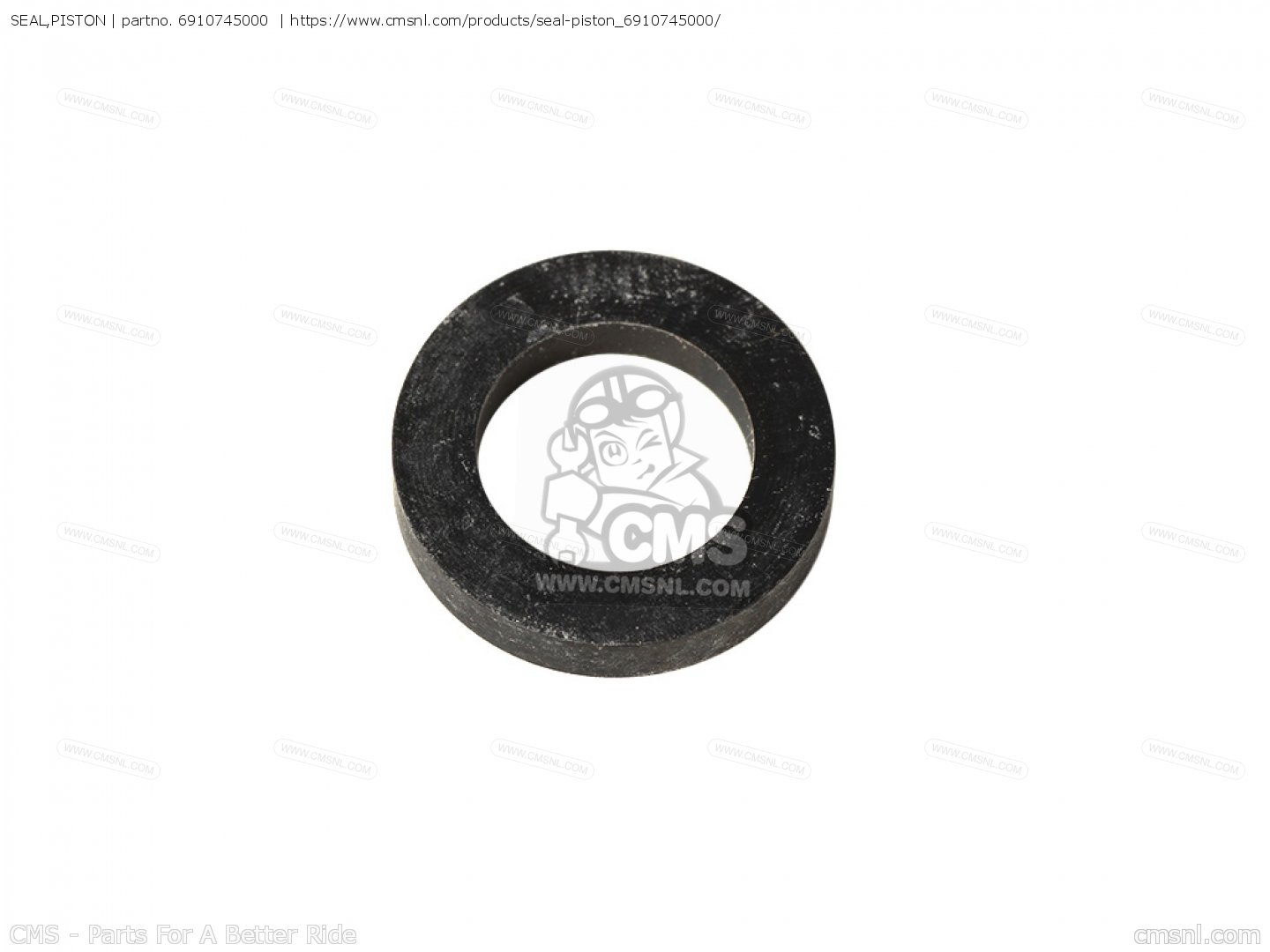

      Or you could undo the bolts and split it in two halfs and apply the air direct to the passage.
      Theres a small seal in there you will need a new one.
      http://www.cmsnl.com/suzuki-gsx750-1...on_6910745000/
