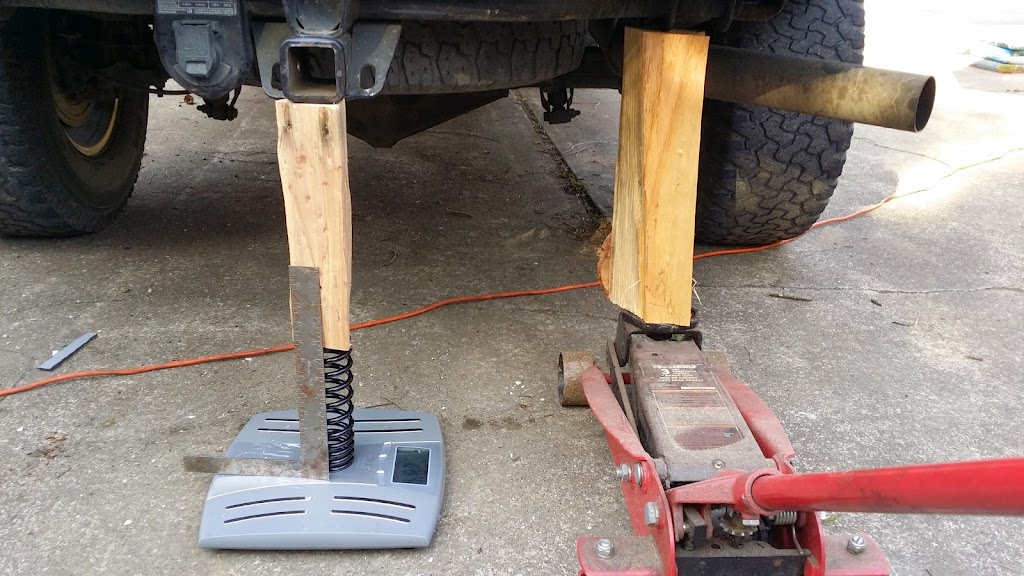

    I was a little concerned about the springs being "HD" because they seemed almost identical to me. So I concocted this Redneck Spring Rate Tester using my diesel truck as the press. Chris Livengood uses a dial indicator, his shop press, and I'm sure a more sophisticated scale. This digital scale was really testing my patience. It locks on a weight as soon as it's stable for like one second.
    Anyway, here's my test results:
    STK springs: 1″ = 122 lbs. 2″ = 247 lbs.
    HD springs: 1″ = 142 lbs. 2″ = 269 lbs.
    Indeed, the HD springs can be called HD. Not by much. I would give my measurements a fair swath in the area of error, but I would assume the Stock springs are 125 lbs/in. and the HD springs are 140 lbs/in.
    Don't laugh, it's the best I could do on quick notice.
