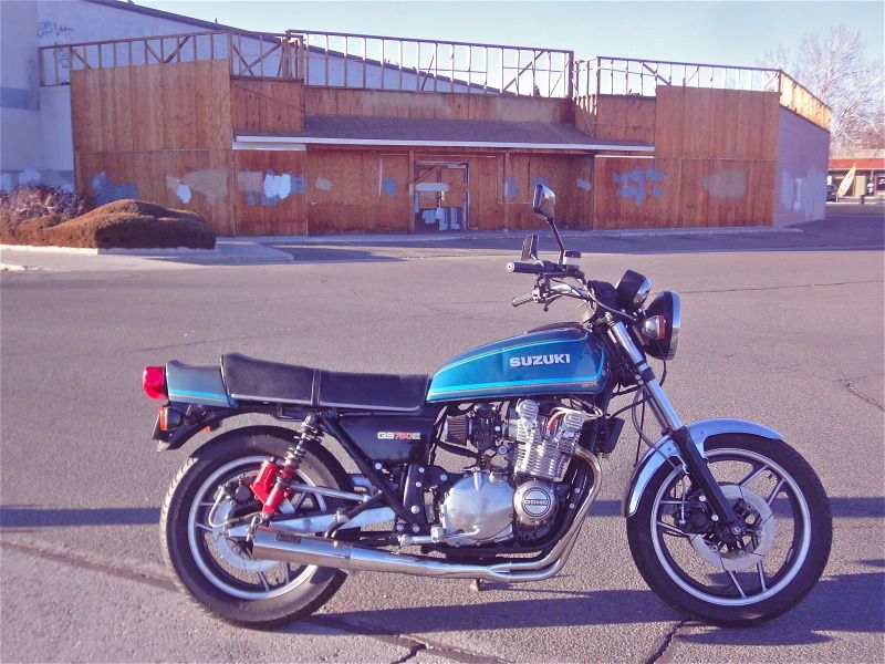

    Eric has already done the mod your asking about. (see photo).
    I'll PM you his contact info.
