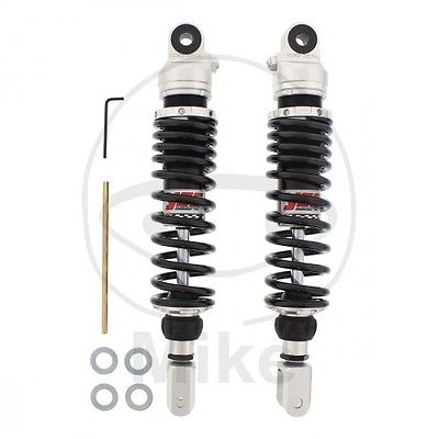

    I'm over the pond in not so sunny England at the moment and just been offered brand new top line YSS shocks (bigger damper rod and better materials) for $330
    strongly considering them as I'm sure a few people here have used them for classic. Racing
    any comments before I "flex the plastic "

    Which model? The photo shows the model with adjustable rebound damping. I think those normally sell for about $500 new.

      Will the spring rate be correct for your bike and usage?

          For racing, you might want to save up for the G series with full adjustability and the increased temperature stability of the remote reservoir. I don't race with mine, but I knew I wouldn't be satisfied with less adjustabilty. Either way, you won't be disappointed with the quality is the springs and damping are right for your bike.

            I bought - RZ362-335TRL-01-X with a slightly stiffer than stock spring as I'm "robustly built" .... but its only a 12mm shaft and I wanted 16mm (RZ366) , however at $330 they'll probably do as its going to be a low mileage bike and definitely not on track.
            I just couldn't bring myself to buy into the extremely cheap chinese shocks OR spend ohlins/wilbers money this time around .... So I'll suck it and see
