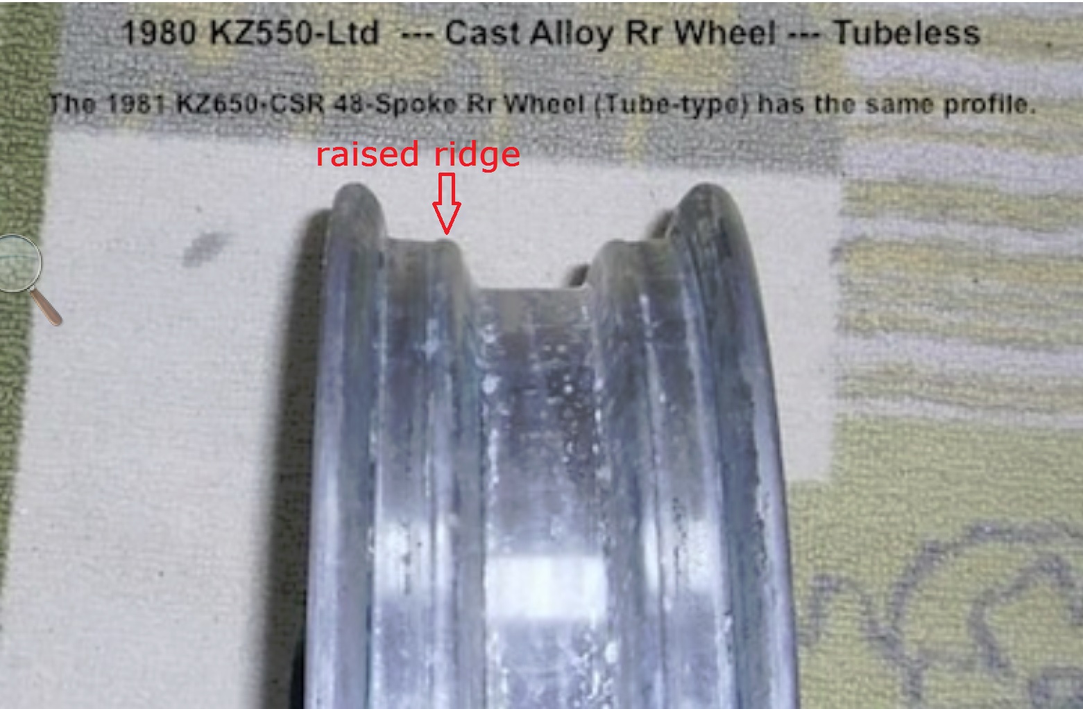

Repeating myself here but both Suzuki and Kawasaki sold "Tubeless Tire Applicable" wheels (front to be specific) that did NOT have the extra rim bumps common to tubeless wheels. Apparently these companies did not feel these features were critical to the design, at that point in time anyway. These wheels differ from the tube type wheels though in that they have a flat machined in and around the valve stem area. This allows the tubeless valve stems to have a nice flat area to seal against.
The following photos are from brwinger and show how to mod a tube type wheel to accept a tubeless valve stem. Converting your tube type wheels like that effectively make them just like the early tubeless wheels both Suzuki and Kawasaki sold.
In later years both of these manufacturers did add the extra safety bumps to the rim profile because it's a positive safety feature. Does that mean that the early wheels are unsafe? No.

The following photo shows what the safety bumps look like. Clearly, these wheels are safer since they hold the tire on the rim bead in case of deflation. This safety feature will function the same though regardless of whether or not there is a tube inside or running tubeless.

Jeez, I wasn't trying to make anyone mad here. Nessism, my wheel doesn't have the bumps shown so nicely in your photos but it does have an already flat spot that accepted my replacement valve perfectly. The inner rubber gasket for the valve stem was a perfect fit for it. The tire I pulled off the wheel was a Continental super twin (tubeless) and has the matching tire on the rear (tubeless). Sharpy, I hear your concerns and will take that into consideration as well. I won't be getting on this bike for months as I rebuild it.
