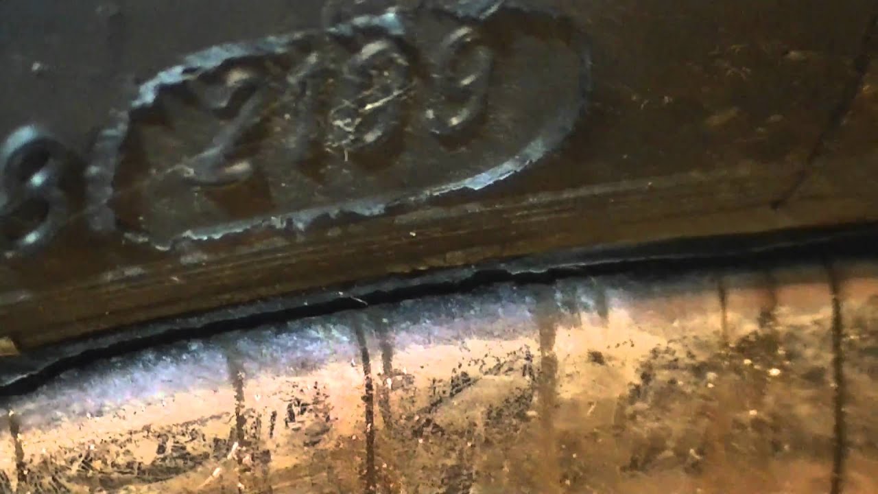

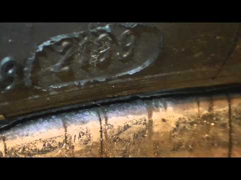

can anyone tell me where to look for date code for tire age the tire is a Metzeler and I've looked all around and can't see anything am i been stupid, and if i find date code how do i read them thanksTags: None

well ive looked all over and found the little oval on the tire and it has bkf 454 anybody make any sense of that

Try google. There are countless links on how to read tire date codes.
My guess is 45th week of 2004. Time for a new tire.Ed
