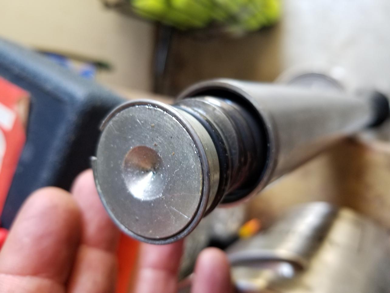

    I finally figured out how to remove the fork cap and sharing this information, since I didnt find it all that intuitive. Not my first time working on forks.
    The fork caps on the GR650 do not have a nut, but a cap that is secured by a circlip. Sharing some information about the forks and how to replace the springs.
    Since the bike is almost 40 years old, using a mallet and screwdriver handle, I gave the cap several wacks to loosen the crust built up around edges. Otherwise it was very difficult to get the cap to budge.
    Now the trick is to find a way to depress the cap, and then coordinate removing the circlip. I used a phillip screwdriver, and a regular pick to remove the circlip. It took about 4 tries to be able to depress the cap while attempting to remove the circlip. It is possible, just need patience. Beer would probably help too.

    Here's some additional photos
      From another angle

                            I just went through replacing my front springs on my GS650L. I used the progressive springs.
                            For the compress + remove circlip dance, I found something that worked very well for me. If you have any wood clamps handy, the long ratcheting kind like these https://www.amazon.com/IRWIN-QUICK-G...gateway&sr=8-3, with the forks still on the bike you can put one end over the top of the fork with a socket underneath it (small enough to go over the air valve but narrow enough to leave room to get to the clip) and wedge the other end down below somewhere on your triple tree. Took a little fiddling to find the perfect spot but once things lined up, I just compressed the clamp and voila, the spring seat was depressed and I could fish the clip out.
