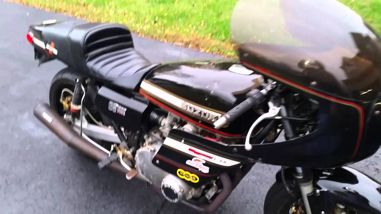

              I think if you upgrade to Sonic springs you will like the way it handles.
              Several members here have done so inc me and i like the handling.
              Their spring rate calculator is here :
              I later added a MikeXS damper valve (https://www.mikesxs.net/yamaha-xs650...170-00-00.html) (these are 35mm dia so i had bushings made to fit my 37mm forks) and a fork brace, but that did not improve much.
              I looked at other forks like GSXR stuff but the smaller wheel and shorter forks took away too much ground clearance.
              If you want more improvement and better brakes you could consider a front end from a Honda VTR1000f Superhawk like this guy did :
              (i think all that was needed was an All Balls conversion kit)
              There are others here with more experience with these fork swaps,
              but here's a list you could use for comparison :
