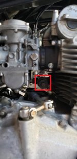

I feel really dumb, but I have a question about the idle adjustment knob on my 82 GS650L.
The other day I put new carb boots on my bike and I must have upset the carb balance during that process (or maybe the new boots just aren't breathing as much as the old ones did), because I started to get too low of an idle. After warm it was idling under 1000 rpm and kept stalling out on me. So, I thought I would just adjust the idle knob. The manual states to start by screwing it all the way in, then backing it out 2 turns as a starting point. Mine just doesn't do that... basically, it was already almost all the way backed out. I got a hair more out of it which seems to have helped the idle, but what was also weird is that when I tried turning it in, it barely moved. I got maybe a quarter turn out of it and there was a weird flicking / fluttering noise coming from the engine when I did that. Didn't seem right.
So essentially it feels like there is no room to adjust.
This is what I was trying to turn:
That is the idle adjustment screw right? I feel so dumb right now but something doesn't seem right.
NOOOOOOOO! Don't turn that. that has nothing to do with your carbs. That is the automatic cam chain tensioner, and it should never be turned when the bike is running. the idle mix screw is on the back bottom side of the carb bank. I'll try to find a pic.

These may not look exactly like your carbs but its the knob at the bottom center in the middle of your carb bank that is your idle adjustment screw.

Yes! Thank you, I see it now. It is in the same place as pictured. So another dumb question, how the hell are you supposed to turn that when the engine is warm? My hand barely fits there as it is... long pair of pliers or something?
I'm thoroughly embarrassed but that's why I love having these forums.
Ahh, yes. just get a longish flat head screw driver and put the flat if it in to engage in knob head and tap on it from the side so as to turn the knob to the right to tighten it or to the left to loosen it. With the engine running, you'll hear the idle go up or down depending on if you're turning the knob tighter or looser. Get it settled somewhere north of 1000 RPM or so and you're good to go. At least that's where my idle seems happiest.
