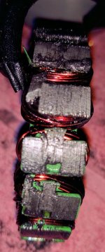

Just finished installing a new Caltric stator and took the bike for a quick spin.
Everything seemed fine until I got up to a stop at a traffic light. I heard what almost sounded like a bolt rattling around in the left side case. Only lasted for about 3 seconds.
Turned bike around and as soon as I pulled in the driveway and put it in neutral it made the same noise again.
Took the left side cover off and found shreds of metal stuck all over the stator and rotor. Gouged the magnets pretty bad.
I'm guessing the stator was slightly larger in diameter that the old one even though when I checked it against the old one it appeared to be similar in size? I did notice a little resistance when putting it all back together but due to my inexperience and lack of patience I just thought it was resistance from the magnet. When I started it up initially nothing sounded abnormal at all.
Not sure what to do now as far as getting all the metal out and be mad that I was impatient and cheaped out on the part just so I could finally start riding again. Stupid expensive mistake.
I'll attach some photos for your viewing pleasure :p

Huh! that's very sad...it's odd that one just one magnet is severely gouged? If the stator were oversized or out of round I'd expect it to rub the whole magnet....and
...looks like there was something stuck to the magnet or the stator that got in the airspace?
Huh! that's very sad...it's odd that one just one magnet is severely gouged? If the stator were oversized or out of round I'd expect it to rub the whole magnet....and ...looks like there was something stuck to the magnet or the stator that got in the airspace?
This is what I thought as well. I suspect the Caltric stator is not at fault, rather there was something stuck to the magnet when you installed the new stator, creating the resistance you felt.
That also seems more likely to me. Haven't come across any missing bolts or sockets that could have been the culprit....yet anyway. There's more than one magnet gouged but not all of them. I'll post more pics but for whatever reason I can only add one per reply.IMG_20200512_221044884~2.jpg
No matter what the cause that's just plain ugly to see. My condolences to your wallet.
agree with that^^ ! it's really Bad luck for sure... it could be something very small that was trapped in the windings from the stator factory or some little thing from your bench....totally pulverised-it might not even have been steel....
Still, your stator windings look ok and the magnets, though ugly, are still magnets. I'm suprised they didn't rip off and shatter! ...You might just be able to change the oil(!) ,clean it up, slap it together and carry on awhile?
Still, your stator windings look ok ....... ,clean it up, slap it together and carry on awhile?
I don't know. That pic of the stator in post #2 would not inspire me to reinstall it.

Yeah if anything I will just keep it as a paperweight. I'm going to clean it all out and go for round number 2 with a new stator. Can't seem to find a replacement rotor at the moment though.
In my opinion (for what that's worth), you did not "cheap out" on the stator. :-k
I have installed several Caltric stators, all with good results.
Like any other stator, they will last a LOT longer if you also install an SH775 R/R.
Yeah, a different R/R would not have saved your stator from that damage, but I agree that there must have been something stuck in there when you installed the new stator.
