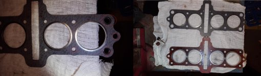

Hi. I bought gasket set long time ago for katana 1982. Today I check cylinder gasket and it doesn't fit easy as old one and it have 2 more holes . I don't know if I can use new one either old one btw old looks pretty solid and better . New "grey" is I think cut a bit differently Also I can't find right part number on webside
http://www.cmsnl.com/suzuki-gs650gl-1981-x-usa-e03_model16042/partslist/BLCK0012.html#results is two different
[h=3]1114134200 or 1114134202 [/h]and third one is stamped on old original 899235 I wish reuse old one but I am not sure if is safe
Head gaskets can and have been reused. In some cases straight back others with lots of sealer of some kind. Neither is recommended and if it works you got away with it. The chance of it working is low.
Replacement gaskets, especially non Suzuki, are frequently not an exact fit and require trimming around the locating dowels for example. Sometimes the fire rings are not centered exactly but that is tolerable as long as they don't come into the cylinder. The two extra holes you have , I don't think count for anything. Missing holes is a bigger problem. The big holes at the corners vary depending on whether the seal washer in integral to the gasket or separate.
