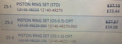

I need to get new o rings for #4 piston but I found two sizes? How do I know which ones I need?

You need to determine if your pistons are stock or oversize. The info you posted clearly shows the part number for each size. Measuring the pistons with a pair of calipers would help. Also look at the piston crowns. Typically oversize pistons will have .5 or 1.0 stamped on the crown. If you have Wiseco pistons though that won't be the case.
I measured the piston and it was 71.9 and with-in service limits and is the STD size.
I'll order the STD ones.
