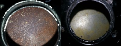

Well the tank clean out went quite well with the cider vinegar, just some flash rust to get out, will use a phosphoric acid based product for that. Here's the before & after through the sender hole
