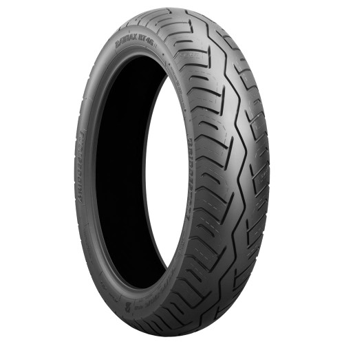

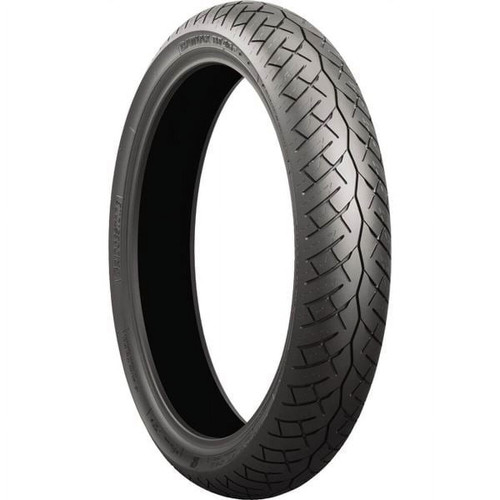

That which you seek is the Bridgestone BT46, the update to the beloved BT45, which seems to have good stocks, and is an unquestionably premium tire for our ancient steeds.

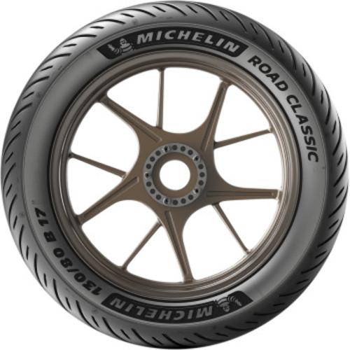

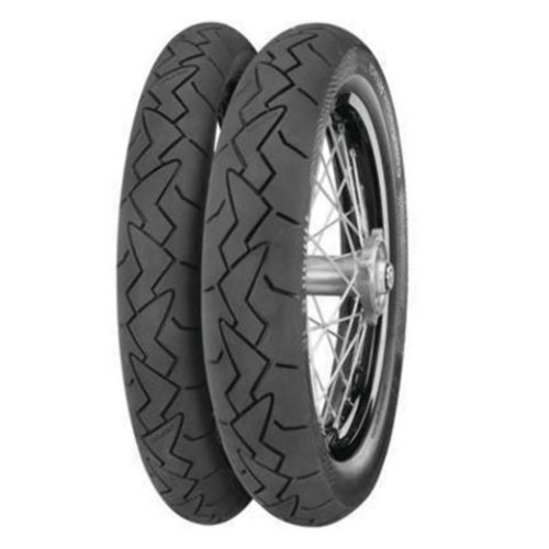

The Michelin Road Classic and the Continental Conti Classic Attack are also great tires that also give you that premium experience of paying through the nose. I haven't tried them personally, but from what I've seen they seem well-regarded.

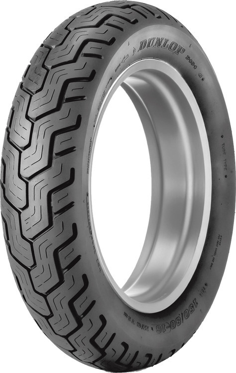

The Dunlop 404 works pretty well when fresh; I've found them lacking in longevity and consistency as they wear, but then again my motorcycle tires lead exceptionally brutal, exciting, but very short lives.

If it's a 110/90-18 rear that's the sticking point, then the BT46 and Conti seem to be available:
