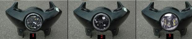

which one of these headlights do you guys like best?

I'm planning on getting one of these, I just can't decide which one.
I like the second one bc the first it looks like it has those angel eye thing around them? not much of a fan of those.
I like the second one, too, it looks less "busy" than the other ones.
It would be nice if we could see them or at least know what they are.
Links to the items would be icing on the cake. :encouragement:
I would guess the light pattern might be a relevant discriminator, but we have no such info.
Yes a shameless lack of detail. Form does follow function after all.
I choose 3 as two is trying to hard to look normal.

The light shown as #1 says it's currently unavailable and there is no price given.
The light shown as #2 is pretty much what I have in my 850, except I have the rectangular version.
The light shown as #3 is the popular choice for the Harley crowd, but they buy the version that has "H-D" embossed on it and costs about three times as much.
I have seen a comparison test that had the earlier version of #2 (Trucklite Phase 6), the current version of #2 (Trucklite Phase 7) and #3 (J&W Speaker Day Maker sold by H-D). If I remember the test correctly, each light excelled at one or more functions, but the overall favorite was the Trucklite Phase 7 (light #2).
If you are changing your headlight to achieve a "look", that is a VERY expensive way to do it. If you do a fair amount of riding at night, why don't you have your new light yet? Keep in mind that these lights draw less than half the current than stock lights, so you will also want to be sure to have a series-type R/R, like the Polaris or Compufire, installed to avoid frying your stator.

But if I had to choose, I'd go with 3, provided light spread and pattern was equal on all 3, which it won't be...

But its my understanding that prior to around 2000, DOT lighting standards called for something like 20% of the headlight output be directed toward overhead signs.
And that headlights designed after the DOT standard change have better lighting patterns.
If the Truck-Lite is too expensive, than a good cheaper option worth considering would be a newer reflector + LED bulb.
Another plus for the Truck-Lite & JW Speaker headlights is that they are DOT compliant.
When researching headlights for the cafe project, I was surprised at how many are “not for road use”, or “not for highway use, or …
About the only ones that are DOT approved are an LED/Lense combination that is typically approaching $200+.
Most everything else is "Off road" or "work light".
In the link I posted there were examples of high end lights with a step to create the flare of light to illuminate street signs far above the normal line of site to oncoming drivers.
I don't know why those photobucket links keep breaking, but there is a picture attached to this post with a high end "step".
