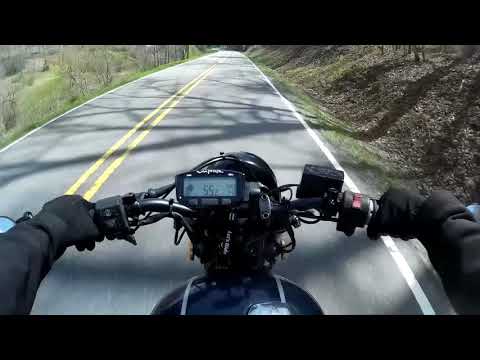

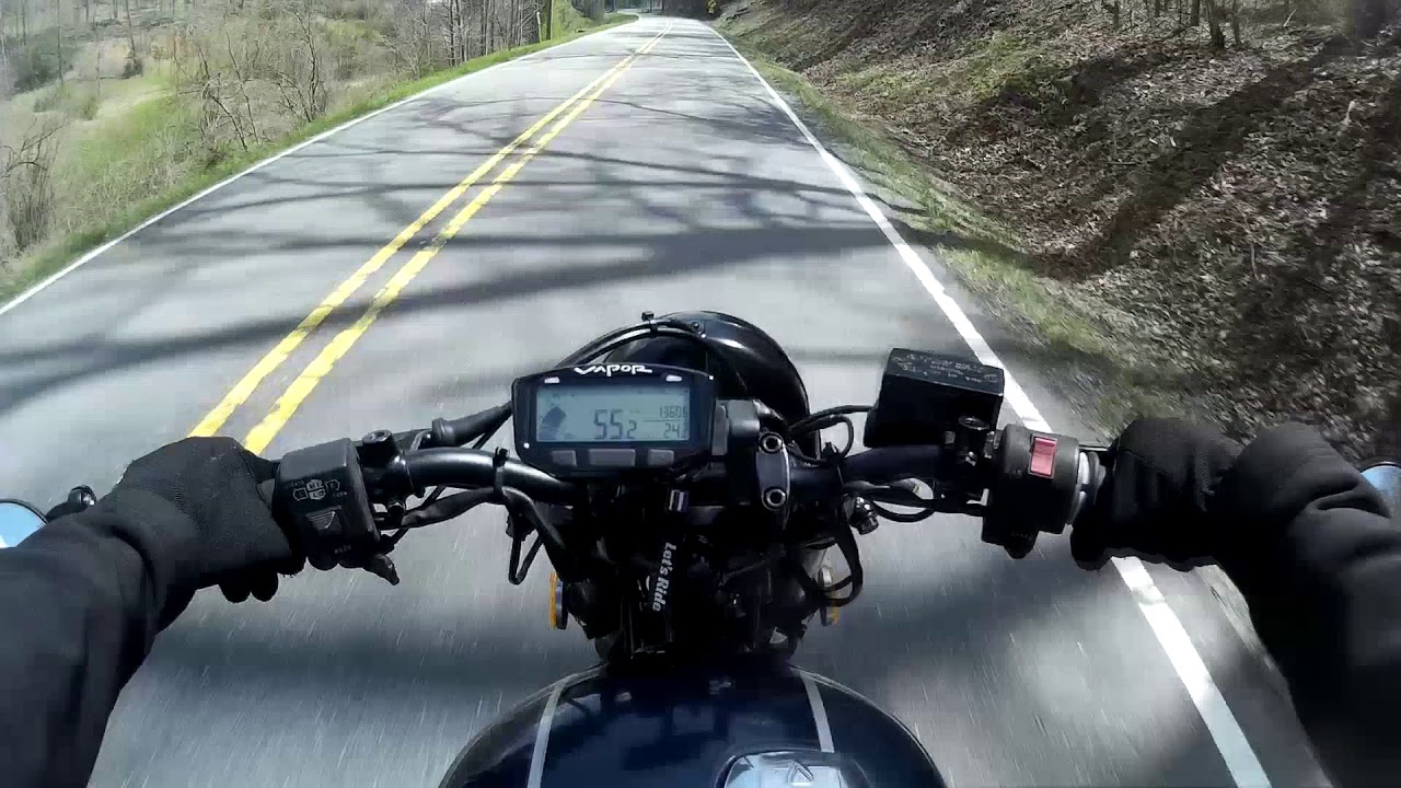

    Video of a ride to the store on my '82 GS750TZ. Figured some of you here might enjoy it.

      I see you have a Vapor on your bike, how well does it work? Was it difficult to install?

        It works good. Speedo is dead on accurate according to my GPS. Tach seems accurate. Easy to see in day or night. Installation of everything was easy aside from the tachometer wiring. The units are mostly designed for single cylinder off-road/dual sport machines. So the extra cylinders on a GS cause interference if you follow the included instructions. You have to solder a 680K resistor into the tachometer lead, and run it to the negative side of one of the ignition coils, and switch to R series spark plugs. At that point you should get an accurate RPM reading.

          That tach sounds to have and easy to install if you know what you're doing.
