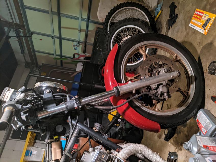

      The forks will lend clues as well. Can you post a pic of the front end?
        Front forks, tank, and rear fender help ID model.
        carbs and front disc help ID if prior to 1980 or not.
          Don't jump to conclusions on the forks. The '80/'81 GS1100 and 750 both had leading-axle forks. Any other year and any other size bike, the leading axle would make you think "L". There is nothing wrong with leading-axle forks if the rest of the bike is designed for them.

            AWESOME info, thanks! Not sure how I missed that label when I was checking the VIN against the title, but looking at it, the bike is as I suspected an '81 GS1100E.
              I didn't realize the E had leading axle. Thank you. Honestly, I was expecting to see anti dive mechanism on there, but I guess that was added on later models.
              There are still subtle differences in the forks for '81 1100's though, like the schrader valve on top of the 8 valve L vs. turn dial thing on bottom of the E.
                Definitely an 80/81. The actually cc size for the 1100 is 1049. Guess they like rounding up lol. I believe most of the 8 valve 1100s were shaft drive.
