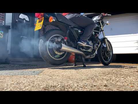

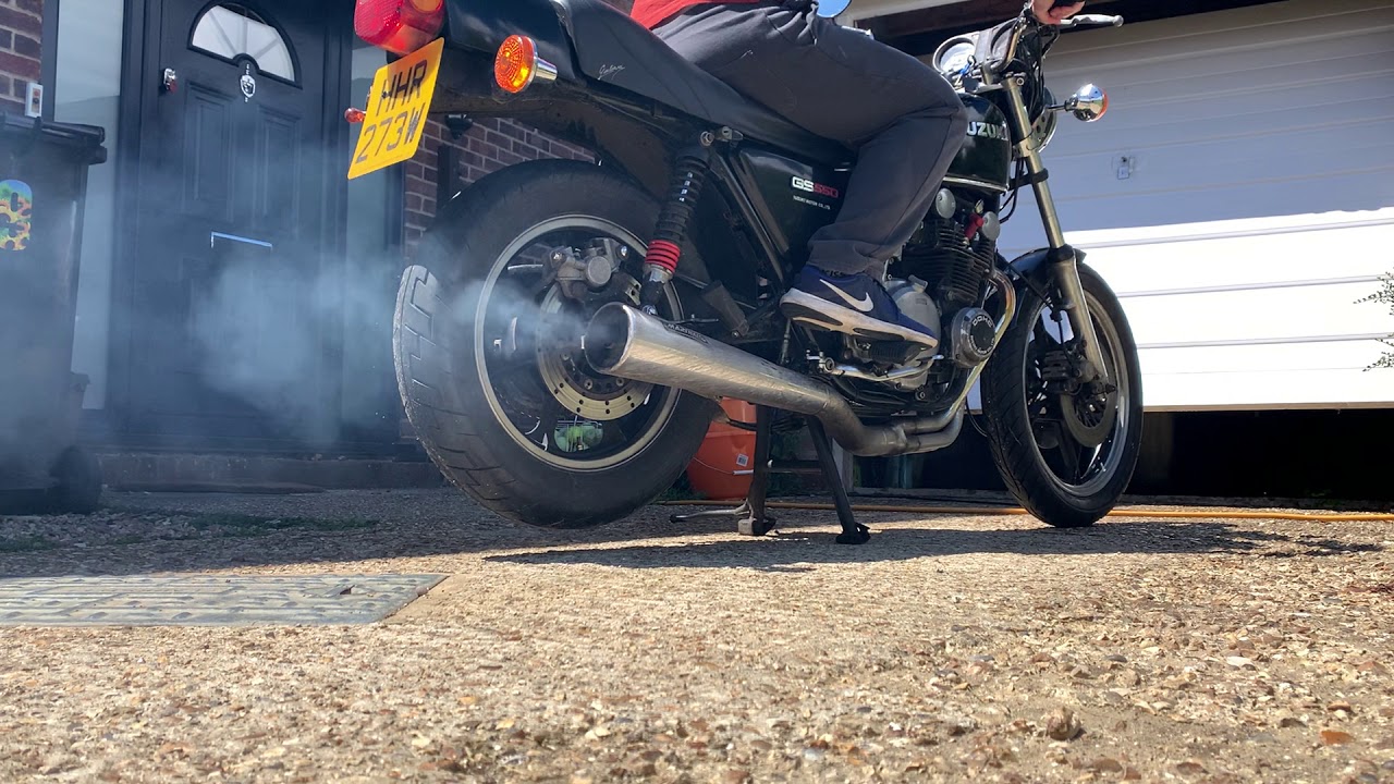

              I pulled it from the garage this morning and it started on the button. It does appear to have a rattle that wasn't there. I'll have a look into that today and it tends to smoke a bit on start up as well as have a fluffy throttle. i put that down to the crappy pods.

                Smoke on start up is almost certainly due to hardened valve stem oil seals. They should have replaced them when they replaced the cam chain (wonder if they actually did that - I've never replaced a cam chain on a 550 as they last forever).
                Rattling sounds like blowing exhaust gaskets, though never easy to tell for sure from a video.
                Those jubilee clips on your carb rubbers are a bad idea. They don't fit properly and your carbs are either not slotted in correctly or the rubbers are trashed.
