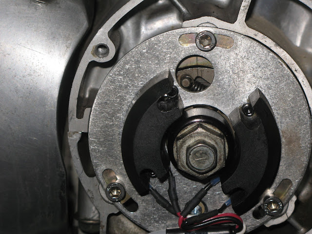

    Just about finished with re-building my motor (new rings, lapped valves, new cam chain) and Im running into an issue while trying to get the mechanical timing right. The exhaust cam seems to be in the correct position but the intake cam looks like a degree or so out. I made to sure count 20 pins between the 2 and 3 arrows, and its was to little of a difference for it to be off by a link (I tried). When I look, the the arrows they look pretty much right (1 point directly forward, 2 points straight up, and three points one pin off from straight up) but the rectangular notches are not in line with one another. I have also checked the idler and there is no play and seems to be in great condition. Does anyone know what could cause this?
    I have included pictures of everything, Let me know if there is any more info or picture that could help.
    Timing looks good. Don't worry about the notches.
      Cool thanks, now is that because the notches dont really matter?
        The notches are there more for a quick visual "sanity check" -- they're a bit approximate. The "T" mark and the marks on the camshaft sprockets are the important parts.
        Looks fine to me, too. Button 'er up!
        Great pics, too!
        (What happened to that poor acorn nut in the fourth photo?)

          Thanks, I figured pictures would help more than me just trying to explain it with text.
          And that acorn nut was mutilated by a PO unfortunately. Looks rough but has good threads and still fits well in the socket so I just kept it.
          Thanks for the answers guys it put my mind to ease for sure.
