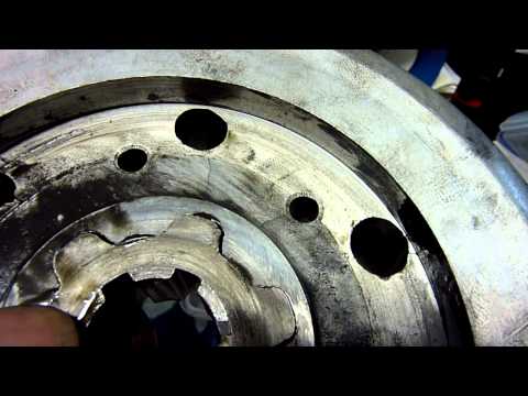

    We've all had problem noises from our clutches. Loose springs on the back plate has always been cited as a cause but I never got that the rumble was associated with a few loose springs of little weight. Often it's said the the clutch hub nut is loose. But what happens when you tighten this up and the noise is still there?
    The drag racing brigade will say it has to do with the helical cut primary gears pushing sideways on the clutch and over time wearing some component that keeps the whole sha-bang nice and tight.
    I discovered another reason today and it is the steel insert in the inner clutch hub which has come loose:
    And this is what the movement looked like:
    So I am swopping that hub out for another that I have.

            just watched your video on this topic...
            the machined look on the basket edge is from a long(wrong) bolt in a through hole on the clutch cover/engine case.
            i heard you mention this so i thought i'd pass it along.
