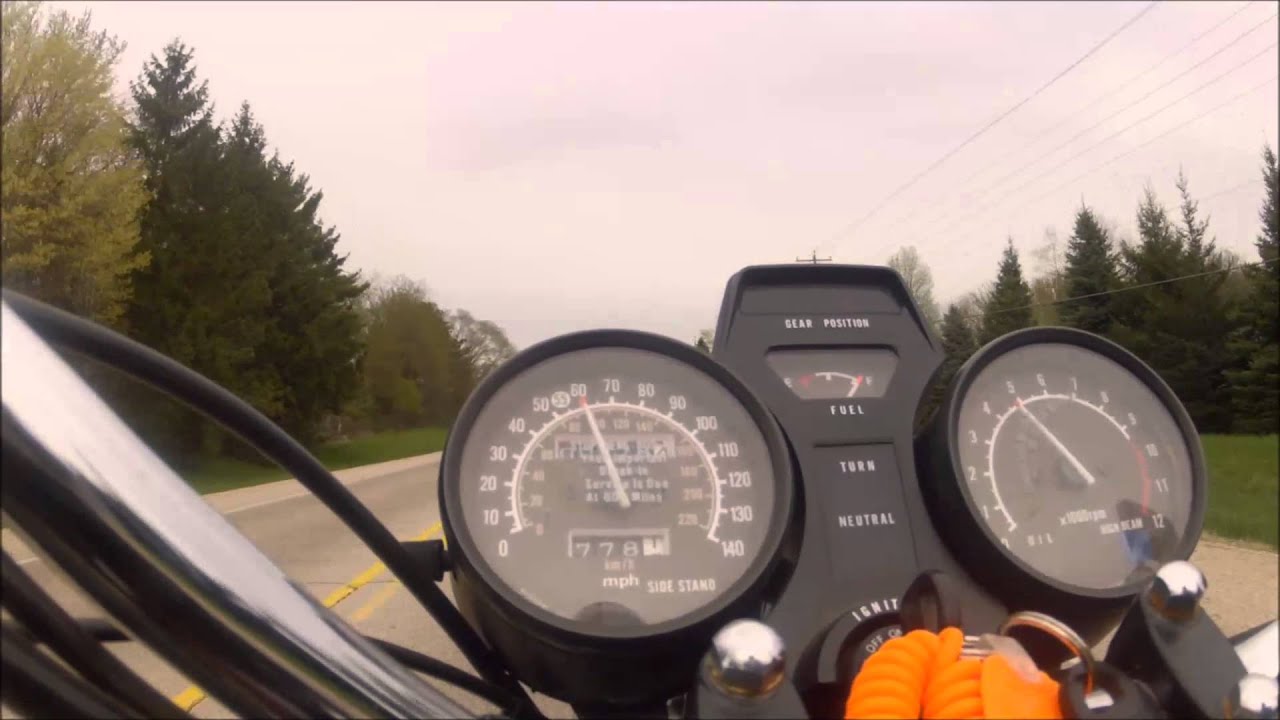

        ^^^that tach looks "lazy" to me. sticks just past 5000 but I think I can hear more change....and I'm really sure my tach would above that at 70mph (120 kmh here)
        RPM's at high speed freeway driveing at 80 mph taching 7000
        that makes sense to me (I have a 650G) but again, these ol' tachs do not seem to age well. The magnet wheel that drives the needle is steel and magnetised steel is not a forever thing....but neither is the lubrication inside. Goes to gum after 30+ years.
        But checking the gear ratio would be a best-test for accuracy. I could easily be wrong. They can over-read too if the cable is jumpy if the"counter-spring) on the needle is tired....
