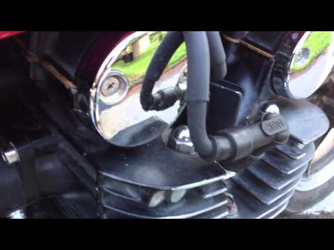

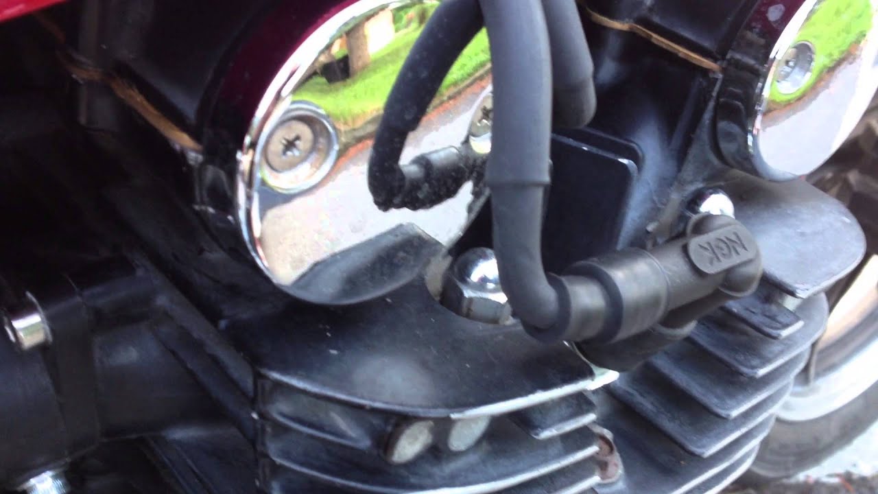

    have an intermittent tick that i can pinpoint to the left side of the motor i think somewhere in the vicinity of the camshaft area, it sounds like a small metallic ting, almost like an electrical tinging but im not entirely sure. my bike does run fine and smooth, i operate on all 4, and nothing electrical that i have hooked up is being problematic. i dont have my horn hooked up and the wires are taped up on the left side of the frame right around the same area but i dont think thats it.
    i will have a video soon enough but it may not be heard the clearest, therefore i will mark each time you can hear the sound. i will say i was idling at about 950-1000 when i could actually hear it, once im idling at the proper 1100+~100 rpm i cant really hear the noise so it couldve been there all this time but then again im not sure.

      Probably just hearing a little valve tapping. Have valve clearances been checked ?

        its been a while, nowhere near the service interval but i will probably be checking anyways within the month, took it to school today (hour 20 round trip) and bike was acting fine, sometimes it acts up in the low rpms but not enough to bother me as its not every single time im in those rpms, cruises at 70 just fine. the bike throws noises here and there but never affects how its riding. gonna hook a gopro up to the bike and put a mic right next to the engine and other areas to see if any sounds are alarming.

                Fitting a camera/mic close to the engine on a air cooled engine will likely give you more to worry about you will hear noises you have not heard before. Ask me how I know.
