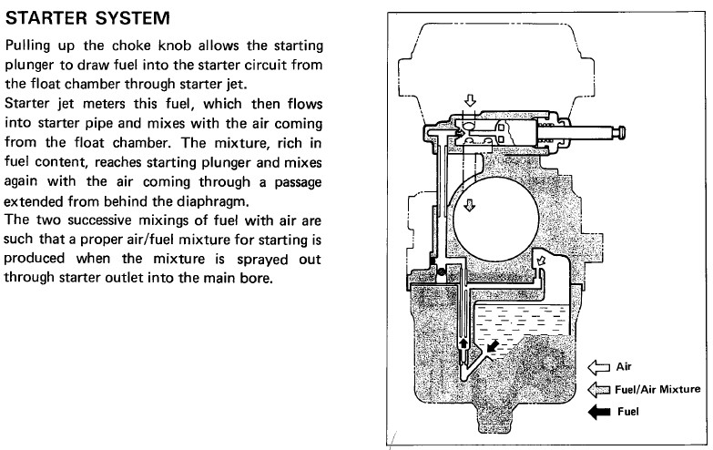

                Properly jetted Mikunis don't start happily COLD without some use of the choke*. The 'choke' is actually a mini carburetor that shares a common casting with the main carb. It draws its fuel from the float bowl and its air either from the bell mouth inlet (sometimes the atmospheric space below the diaphragm in CV carbs). The choke plunger is the mini carb's slide and needle. It relies on the engine vacuum provided by a fully shut throttle to draw enough air though it to operate, so cracking open the throttle to cold start lowers the vacuum kills the chokes enrichment.

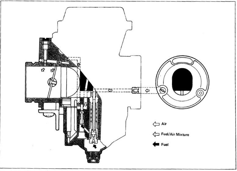

                      So the main jet is 5 sizes larger. Which is quite a bit richer, if the engine is stock with stock filter. This would be noticeable only at high rpm on a WFO throttle, say the last 2,000 - 2,500 rpm before redline. The twist grip controls the butterflies, but its volume of air passing underneath the slide at any given moment that lifts the slide up and that volume is dependent upon the butterfly position AND rpm, so the main jet isn't doing all the metering until a lot of air is being sucked through and the slide/needle is fully up. So that won't be affecting cold starting.
                      The pilot air jet /pilot circuit is separate from the cold start circuit, so doesn't directly affect the cold start circuit. The pilot air jet meters air to the pilot jet (fuel) which has air bleed holes on the sides of the pilot fuel jet and it is here that air is mixed with the fuel drawn up from the float bowl (via the main jet in the BS Mikuni as its isolated from bowl by the black plug). The AF ratio of the pilot mixture is set by the balance between the sizes of both jets. There are 3 or 4 outlets for this pre-set mixture -the pilot and by-pass orifices. Only the pilot orifice is affected by fuel screw (pilot screw) adjustment. The pilot orifice is the closest to the engine and is always on the engine side of the throttle butterfly. The fuel screw allows the pilot mixture to be trimmed to the air passing past the butterfly which is held just cracked at idle, by the main idle knob.
                      A smaller pilot air jet with the same pilot jet would be a richer mixture for the pilot circuit. Less air for the same fuel volume. Whether its significant or not, depends whether it makes any noticeable difference to how the bike runs at idle (and more importantly) just off idle when you are maneuvering at walking pace, slowly getting underway in 1st, or just starting to add throttle from closed exiting a corner. These are the times when incorrect pilot mixture causes glitches that intrudes into riding. It is mixture that you are hot starting on.

                      The cold start circuit draws fuel through a brass tube that sits inside a passage in the casting of the float bowl. The fuel inlet to this tube is at the bottom of the float bowl. There is also a pressed-in non -removable fuel jet in the passage. These can get blocked with sediment and make the 'choke' inoperative. The bowl are often overlooked in cleaning. Aerosol carb cleaner should be able to easily pass through as a visual confirmation. Be careful not to shoot yourself in the eyes. Carb cleaner stings. The brass tube should also be able to pass carb cleaner up into where the choke plunger is located which should be removed or at least pulled open to prove the flow of cleaner.
                        Thanks for the detailed explanation of the various circuits. I tried to educate myself on these circuits and somehow came away with the idea that the pilot circuit played a role in keeping the engine running during start.
                        I did finally clean and blow out the tiny passages including using a fine wire strand on the small brass tubes a few days ago. The majority of the rebuild videos don't even mention this. At least I know for sure that they aren't blocked now.
                        I did go ahead and purchase the stock jets and a used idle knob screw and should have the carbs put back together and installed this coming weekend.
