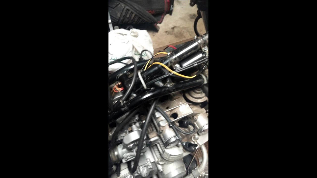

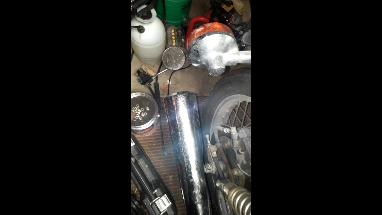

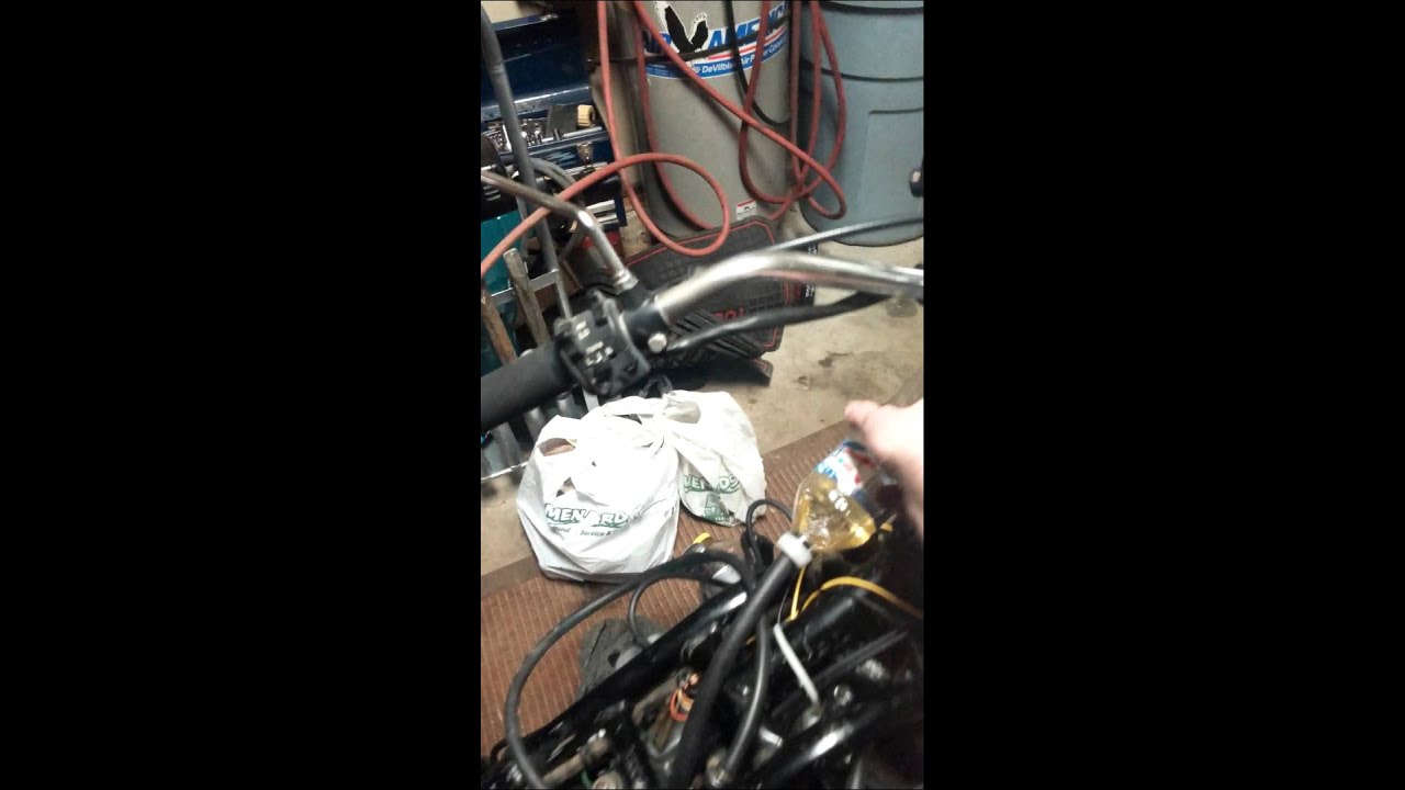

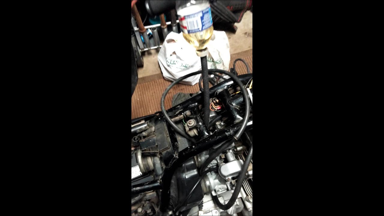

                    The bike will run for a while now, it may even be able to be driven. Although the rear brake needs to be serviced, needs both tires, and needs a headlight. Here are some pics and videos for the update, it still dies every now and then, and Im not completely sure why, and the tachometer does not work. I have set the air/fuel mixture screws at 1.25 turns out from gentle bottom, the fuel pilot screws on the bottom to 3/4 out from gentle bottom, the floats adjusted to 0.914" to 0.918" on each.
                    Choke has to be all the way open at all times, any lower adjustments and the bike will die right away.
                    Here is the rigged up "gas tank" with the 'capped' vacuum line that goes to petcock.
                    Heres the videos. Read the descriptions on them for info.
                    Link & Desc. https://www.youtube.com/watch?v=3fIs...ature=youtu.be
                    Link & Desc. https://www.youtube.com/watch?v=29PUuonf0Gc&feature=youtu.be
                    Link & Desc. https://www.youtube.com/watch?v=rsulCJiWIfA&feature=youtu.be
                    Link & Desc. https://www.youtube.com/watch?v=9prT...ature=youtu.be

                          It's good that it's running, it mainly looked like fuel starvation - crap in the tank, faulty/blocked petcock plus the fuel filter would not be helping.
                          You will have an issue with that bottle you have rigged if I am not mistaken - there is no breather on the bottle which means a vacuum will build up in the bottle preventing the proper fuel flow from happening.
                          Besides giving the carbs a more methodic strip/clean (I used Berrymans carb dip) of the carbs you really need to test out the tank/petcock and once you can see a good fuel flow get it back on - search the forum and it will tell you how to do this
