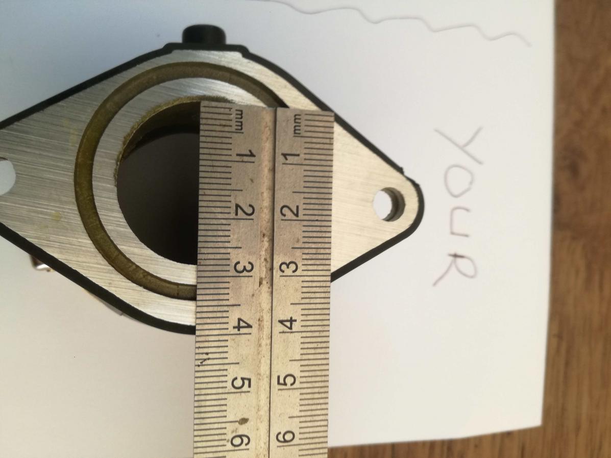

            Thanks for all the replies. I think I have found the problem. I recently purchased a set of inlet manifolds on the internet and found that the thread for the cap screws on the side strip very easily. I re-tapped and put in larger screws with a decent copper washer for better seal. On installing the "new" inlet manifolds, I noticed that the actual aluminium part formed a very slight arch (nearly not visible) when tightening the to bolts due to the O-ring not being compressed completely flat against the cylinder head. Being ignorant, I assumed that it was a good thing and that it was "really" sealing well.
            The problem is quite simple: due to the low quality of Aluminium used, with the slightest heat, the aluminium expands much quicker than the head hence the engine running smooth for a short while and then takes off simply because the seals do not seal properly anymore.
            May this lesson also be a warning to all that the "cheap" inlets currently being offered on E-bay, ALi Express, Picklick etc. are all from the same source and profess to cover the 1980 to 1983 range of 550, 650, and 850 models. These items are pure rubbish and should be avoided. Close scrutiny of the pictures on the internet after the fact show that they are all from the same source. All the "850" ones on offer actually have 28mm instead of 32mm inlets which is false advertising.
            I added a picture of an "850" inlet as I also bought a set for my 850 which I am going to return as they are the same as the ones I tried on my 650.

              That's Interesting and a caution for sure! Good on you! Danie, for finding "it" and reporting back. (but score one for 93bandit who nailed the cause ...even not knowing you had bought new ones.)
