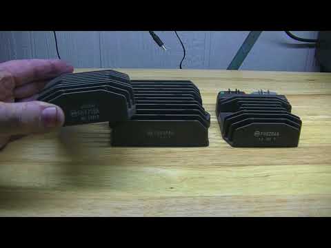

                This may help :
                Rijk

                    Originally posted by Rijko View Post
                    This may help :
                    Cool a handy clip thanks. I had been careful to buy what I thought was a genuine, all my other gs s' have them all original but this was the first one so I got caught out, incedntly it's also the only one that I had bought a new one all the others I put used s/h ones. Oddly the battery used to go flat on this bike it always had a drain on the battery that got worse till the wretched thing croaked.
