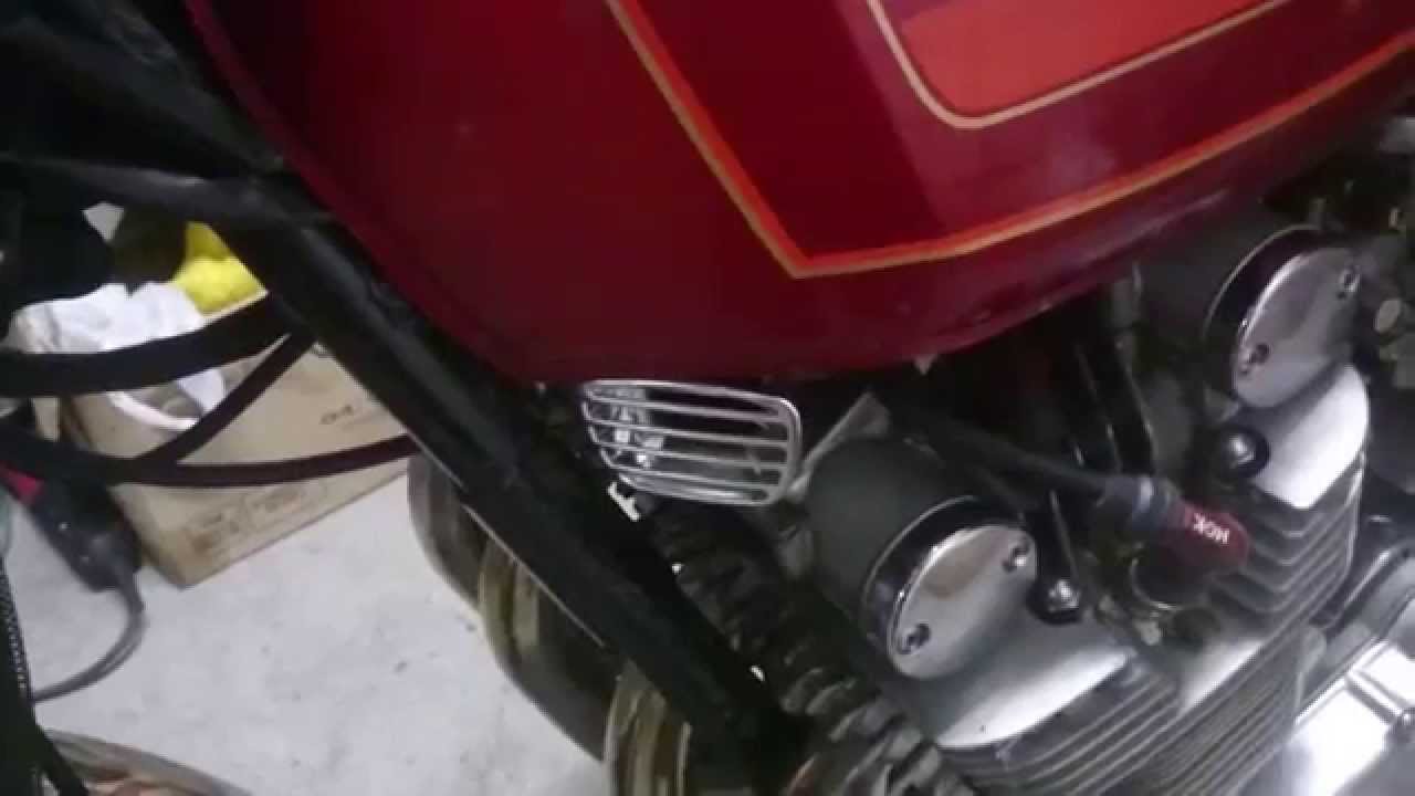

            These are mine
              Just me, I like the ones you can't see unless you get on your knees and look up under the tank
                I did mine like Lorenzo. The Harbor freight horns came with a relay, I wasn't crazy about the sound so I got the Fiam horns out and used the relay on them.
