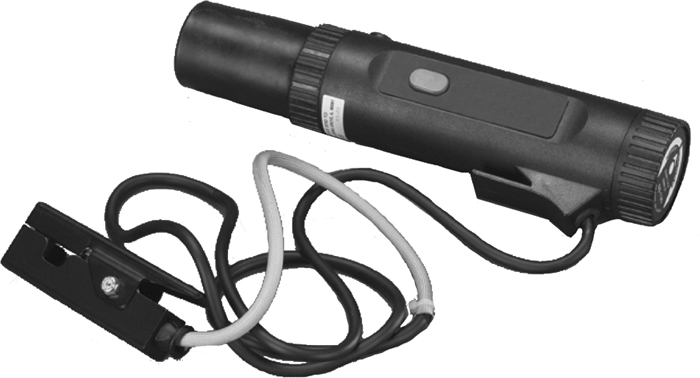

This is what i use, a self powered timing light.
I bought it from a Mercury-Mercruiser dealer about 10 year ago.work on anything with spark plug leads.
The light or degree are not adjustable.
money well spend,
Marc

Originally posted by kochic View PostThis is what i use, a self powered timing light.
money well spend,
Marc
Ooh, I like that -- no battery leads to tangle and fart around with. The disadvantage is that you have to deal with the internal battery. If it's not used frequently, you may pull it out one day to find a corroded mess where the battery used to be.1983 GS850G, Cosmos Blue.
