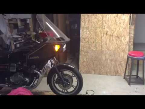

                    Certainly, GR, happy to do it.

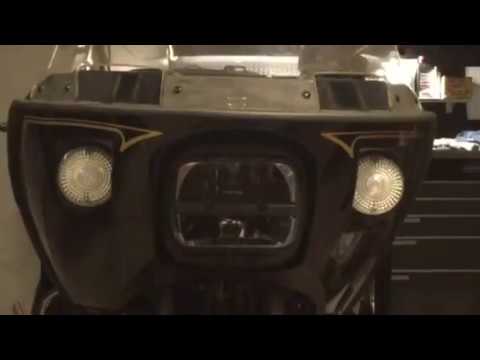

                    When the video starts, the lights are OFF. When I turn the key ON, the lights overwhelm the camera, so I adjust the camera for the light level, then play with the turn signals.
                    In the second video, I pan across the front of the bike to show the viewing angle, as some LEDs are pretty much focused straight ahead.
                    Whether it's legal or not in Canada, you may have some serious trouble trying to duplicate it. The trick to the whole concept is to have CLEAR lenses on the front lights. The lights in my fairing are not the same size as Suzuki lights. I took one of the lenses to a large accessory store (Iron Pony) to see if I could match them up with some clear lenses. The guy that was helping me found some in yellow (amber), we took them up to the counter, where they looked them up in the catalog and found that they were available in clear, but I had to order them. I don't remember exactly which model they fit, but they are Honda lenses, probably off a Shadow or some other cruiser.
                    The light modules that I used were also ... shall we say "not cheap"? They are Dynamic Ringz from Custom Dynamics. The "not cheap" part is $90 for the pair.
                    I tend to justify that the same way others will chop off the rear half of the bike, chop the fenders, flip the handlebars over, all sorts of strange stuff, it's all for a "look". That is the "look" that I wanted.
