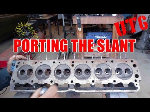

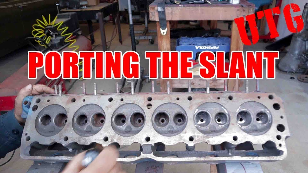

                  Did research on porting before starting.
                  This video was very useful.

                      I found this guys videos recently. His slant head 6 engine build is very informative!
                      Reducing weight by grinding off overbuilt parts and casting flanges, inside and out. Very good concept goals in describing his work on a very crude engine head.
