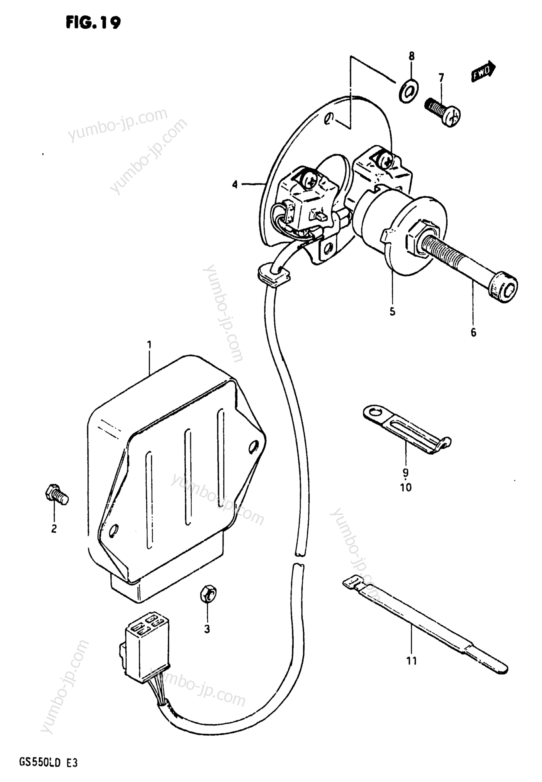

    So here's the plan. The RMStator reg/rec is too big to fit in the stock location, but the ignitor (whatever the hell that is) seems to be enjoying some really nice real estate on the left side. A little customization and I think I can swap the two. The ignitor can move behind the battery, held on by a single bolt
    and the reg/rec can fit in the ignitor's location using one existing hole as-is, and a little help to reach the other one. My plan is to cut a small piece of thin aluminum and make a sort of adapter bracket.

          Treat the igniter with care. This is a part unique to the '83-'86 16 valve GS550 series, and is unobtanium, even a used one on ebay..

              Good to know! Maybe I'll see if I can find it a nicer location where I can use both screws. It's very light, but I have no idea what's inside it or what environmental considerations it needs regarding vibration, ventilation, etc.

                I couldn't find a better place for it, so the igniter is nestled in the old R/R location. It's only held on by one bolt, but it's rather securely wedged between the plastic battery box and the bottom of the seat. I put a strip of adhesive-backed high strength silicone rubber that I had on the back to keep it from rattling metal-on-metal, and to further keep it from moving about. Overall I wish I could find a place to use two bolts, but really this is probably just fine. It's a lightweight part with no moving internals, held at multiple points by some sort of polymer. I think it's safe.
